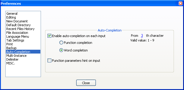

3. Enable CCompletion in Settings/Preferences as show image below:
Close it and restart Notepad++

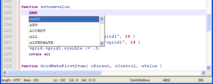

4. To use it, just write first character and will be displayed like this:
Confirm by slecting and Enter.

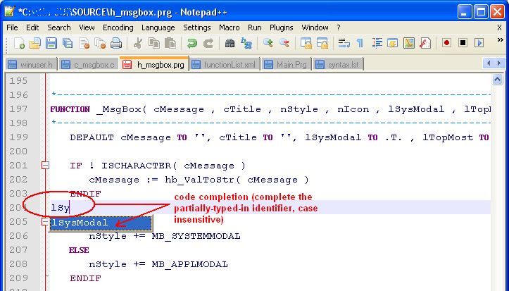

In the configuration for auto-completion, there is an option for "Function Completion":
But for this working, you will need to unpack xBase.rar (here attached file) and put in
C:\Arquivos de programas\Notepad++\plugins\APIs folder.

=== VERY IMPORTANT ===
I just started to re-edit xBase file for "Function completion" and I could not show function sintax without the function name. So I do not know if all of you prefer with or with sintax, see image below:
The main problem when is opted with function sintax that is that is bringing it all together for souce editor.
Without function sintax only function name is bringing.
I will need your prompt responses soon as posible, because I am in doubt what is better for all of us.
(with sintax or without it)
In my opinion, I prefer with sintax, because with it we can making use of the variable names (in standard format) into source editor. ;)
Re: Notepad++ Auto-Completion
Posted: Tue Aug 13, 2013 2:35 pm
I get the auto completion working in my system.
It will be helpful if we have the function name along with the syntax.
Thanks Pablo for your wonderful guidance.
Posted: Tue Aug 13, 2013 2:46 pm
Rathinagiri wrote:I get the auto completion working in my system.
Good ! So I will continue working on "with sintax". But remember, when user make his choice by auto-completion will write function name+sintax on the edition of source.
Posted: Tue Aug 13, 2013 3:57 pm
by srvet_claudio
Rathinagiri wrote:It will be helpful if we have the function name along with the syntax.
Pablo César wrote:But remember, when user make his choice by auto-completion will write function name+sintax on the edition of source.
In my case the syntax is more important.
