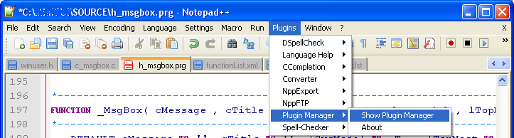

Probably most of you know that some good editors has a ressource of auto-completion during edit. In Notepad++ you need to install it and to enable it. Here is step by step:
1. To see if CCompletion is installed. Go to Tab "Installed" of "Show Plugin Manager", if not go to Tab "Available" of "Show Plugin Manager".
2. To install CCompletion click in check box and run install button.
3. Enable CCompletion in Settings/Preferences as show image below:
Close it and restart Notepad++

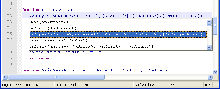

=== VERY IMPORTANT ===
I just started to re-edit xBase file for "Function completion" and I could not show function sintax without the function name. So I do not know if all of you prefer with or with sintax, see image below:
The main problem when is opted with function sintax that is that is bringing it all together for souce editor.
Without function sintax only function name is bringing.
I will need your prompt responses soon as posible, because I am in doubt what is better for all of us.
(with sintax or without it)
In my opinion, I prefer with sintax, because with it we can making use of the variable names (in standard format) into source editor. ;)

Good ! So I will continue working on "with sintax". But remember, when user make his choice by auto-completion will write function name+sintax on the edition of source.
Re: Notepad++ Auto-Completion
Rathinagiri wrote:It will be helpful if we have the function name along with the syntax.
Pablo César wrote:But remember, when user make his choice by auto-completion will write function name+sintax on the edition of source.
In my case the syntax is more important.
