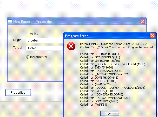

Hi men.
I have still same problem. After definition window and show it, I try manipulate with control (grid, label..) Look picture from example.
I use HMG311 and minigui extended (2.1.9) with same results. "Control: xxx Of Winxxx Not defined. Program terminated,
Can You help me?
THX Dodogo

dodogo wrote: sorry wrong extension in picture file..
you better post an example?
or just use GetProperty( Window, Control , value )
Ej :
 SendEmail.Text_1.Value := GetProperty( 'Incomming' , 'cUser' , 'value' )

dodogo wrote:Hi men.
Hi
Your problem might be this :
HMG Doc wrote: DECLARE WINDOW <WindowName>
A window must be declared using this command, if you need to refer to it prior
its definition in code, or when you refer to it in a different .prg file from
the one it was defined using semi-oop syntax.
Viva HMG :D
