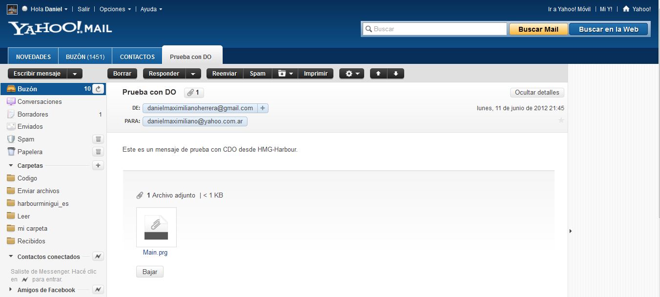

Hi / Hola Salamandra :
CdoSys tiene como enviar un archivo adjunto , eh intentado activar dicha funcion pero me da error, estoy investigando cual es la falla,apenas lo resuelva subo la modificacion.
Translate Google
CdoSys is to send an attachment, eh tried to activate this function but I get error, I am researching which is the fault, just upload the modified work it out.

ya encontre la solucion
      loMsg := CREATEOBJECT ( "CDO.Message" )
      WITH OBJECT loMsg
         :Configuration := loCfg
         :From          := Main.cFrom.Value
         :To            := Main.cTo.Value
         :Subject       := "Prueba con DO"
         :TextBody      := Main.Contenido.Value
         :AddAttachment("c:\Main.prg")
         :Send()
      ENDWITH
if you need more upload attachments / si se necesitan cargar mas adjuntos
  :AddAttachment("c:\Main.prg","file2","file3",more,,)
or
 :AddAttachment("File2")

Hi Daniel :) ,
Tested the following code and it worked fine :P
WITH OBJECT loMsg
	:Subject       := "e-Mail test using <<< CDOSYS (Collaboration Data Objects) >>>"
	For k:=1 to Main.archivos.ItemCount
		:AddAttachment(Main.archivos.Item(k))
	Next k
	:Send()
ENDWITH
Thanks again for your help :D
