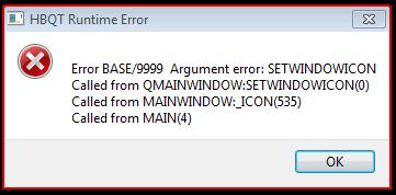

A last note for our friend who want begin to HMG4 ( I guess no too many ): Add
HbQt_ErrorSys()
at beginning of every main prg; this will very helpful for understanding an learning HMG4.
f.e. after adding this line error message produced and problem appears:
Set Window Icon error mesage
Please nobody don't misunderstand me; I don't want criticize anybody, anything. My only goal is share my humble experiences with my friends.

The fact that the program compiles means that the @ x,y syntax is fully supported.
The error is about the parameter of ICON. hmg4 is trying to set icon but its parameter is not the expected type. I will check later.
Please don't repeat said things such your own opinion.
In the example used only parameter is NIL. Does HMG4 don't understand NIL ?
