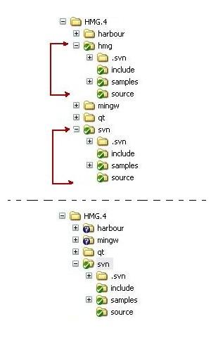

Re: HMG.4 Problems
Posted: Sat Aug 21, 2010 1:31 pm
Hello
Two different HMG.4 <DIR> structures
I'm still confusing :?
<DIR> was building by downloaded HMG.4 setup prg and changed by SVN :?
Which one is correct, and how I can reach that correct way ?
Re: HMG.4 Problems
Posted: Sat Aug 21, 2010 1:35 pm
... and,
struggling under these type of detailed problems make very fatigue me :cry:
