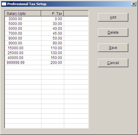

Hi All,
Is there any way to align (JUSTIFY) the 1st column of a grid to right-aligned?
Thanks in advance.
With best regards.
Sudip

sudip wrote:Hi All,
Hello Sudip,
In the official HMG:
You can define the 1st column of a grid with a zero length and place the 'Salary' item in the second column.
In the HMG Extended:
We have a hack in the C-function INITLISTVIEWCOLUMNS (borrowed from ooHG) for aligning the 1st column of a grid :idea:
Nice n simple solution. :)

Thanks a lot Grigory. It works! :D
