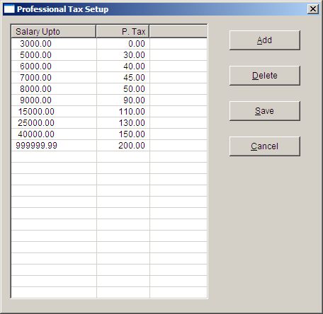

Hi All,
Is there any way to align (JUSTIFY) the 1st column of a grid to right-aligned?
Thanks in advance.

sudip wrote:Hi All,
Hello Sudip,
In the official HMG:
You can define the 1st column of a grid with a zero length and place the 'Salary' item in the second column.
In the HMG Extended:
We have a hack in the C-function INITLISTVIEWCOLUMNS (borrowed from ooHG) for aligning the 1st column of a grid :idea:

Thanks a lot Grigory. It works! :D

gfilatov wrote: In the HMG Extended:
There is known limitation of ListView Windows control about that.
Could be you so kind to post that hack here to review it?
TIA.
Hi Roberto,
Sure. Please take a look for code below: :arrow:
/* code of the function INITLISTVIEWCOLUMNS is borrowed from ooHG */
HB_FUNC( INITLISTVIEWCOLUMNS )
   PHB_ITEM    wArray;
   PHB_ITEM    hArray;
   PHB_ITEM    jArray;
   HWND        hc;
   LV_COLUMN   COL;
   int         iLen;
   int         s;
   int         iColumn = 0;
   hc = ( HWND ) hb_parnl( 1 );
   iLen = hb_parinfa( 2, 0 ) - 1;
   hArray = hb_param( 2, HB_IT_ARRAY );
   wArray = hb_param( 3, HB_IT_ARRAY );
   jArray = hb_param( 4, HB_IT_ARRAY );
   COL.mask = LVCF_FMT | LVCF_WIDTH | LVCF_TEXT | LVCF_SUBITEM;
   for( s = 0; s <= iLen; s++ )
      COL.fmt = hb_arrayGetNI( jArray, s + 1 );
      COL.cx = hb_arrayGetNI( wArray, s + 1 );
      COL.pszText = (char *) hb_arrayGetCPtr( hArray, s + 1 );
      COL.iSubItem = iColumn;
      ListView_InsertColumn( hc, iColumn, &COL );
      if( iColumn == 0 && COL.fmt != LVCFMT_LEFT )
         iColumn++;
      iColumn++;
   if( iColumn != s )
      ListView_DeleteColumn( hc, 0 );       // <-- this hack
