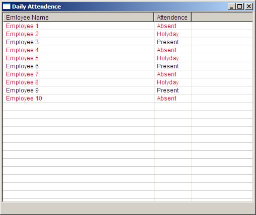

I want to change DynamicForeColor of a Column of a Grid depending on the value of another column of the same grid.
Here is the source code
DynamicColor.zip
(2.48 KiB) Downloaded 436 times
With best regards.
Sudip

sudip wrote:Hello Friends,
This is the smallest and the simplest project I want to share with you ;) . But, forgive me, I can't just resist myself to share the very simple solution I got (thinking 3/4 days :o :lol: ), with you :)
DynamicColor.zip
With best regards.
Sudip
If you are trying to change the forecolor for column 2 based on column 2 content:
Please, replace your DynColor function with this:
Function DynColor(mRow, mCol)
local r
	if mCol == 2
		if frmAtten.grdAtten.cell(mRow, 2) = 1
			r := {0, 0, 0}
			r := {0, 255, 0}
		r := {0, 0, 0}
return r
If you are trying to change the forecolor for column 1 based on column 2 content:
local r
	if mCol == 1
			r := {0, 0, 0}
			r := {0, 255, 0}
		r := {0, 0, 0}
return r

Hello Master Roberto,
Thanks a lot for checking this small sample and for your tips :)
My original sample was also built on your tips :)
Thank you again.
Rahi, it's the beauty of HMGForum that creator of very small things (like me), also encouraged to do better :) Thank you :)
