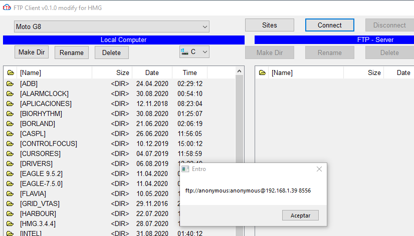

Posted: Tue Sep 22, 2020 8:07 pm
Hi Jimmy:
As we see after general the Url when trying to connect the application remains frozen for a while until it gives an error since the URL is wrong .. that occurs when using IP addresses type B or C
STATIC FUNCTION ftpConnect()
LOCAL bError
LOCAL lConnect  := .F.
LOCAL cUser     := sites->user
LOCAL cPassWord := desencri( sites->password )
LOCAL cServer   := sites->address
LOCAL nPort     := sites->Port
LOCAL cUrl, oError
   cUrl := "ftp://" + ALLTRIM( cUser ) + ":" + ALLTRIM( cPassWord ) + "@" + ALLTRIM( cServer ) + STR ( nPort )
   oUrl := tURL() :New( cUrl )
   IF EMPTY( oUrl )
      RETURN nil
	   msgbox( oUrl:cAddress,"Entro"  )
2020-09-22 17_02_55-FTP Client v0.1.0 modify for HMG.png (32.46 KiB) Viewed 11473 times
Re: NC Clone
Posted: Tue Sep 22, 2020 8:36 pm
by AUGE_OHR
danielmaximiliano wrote: Tue Sep 22, 2020 8:07 pm As we see after general the Url when trying to connect the application remains frozen for a while until it gives an error since the URL is wrong .. that occurs when using IP addresses type B or C
i have add Port in v1.26
please get latest Source from GitHub and look into HBFTP.PRG if it work for you
https://github.com/AugeOhr/HBFM
i just have test it with Port 21
Re: NC Clone
Posted: Wed Sep 23, 2020 2:20 pm
AUGE_OHR wrote: Tue Sep 22, 2020 8:36 pm i have add Port in v1.26
Hi Jimmy, the port addition in FTP applications is to place the service on another port than the default one. as being Android that its FTP service is port 21; in this case, any other app cannot use port 21 as it is busy. that's why File Manager uses another one manually, in my case the 8556
HBtip by default assumes port 21 for FTP services that you can check in C:\Harbour\contrib\hbtip\ftpcli.prg
METHOD New( oUrl, xTrace, oCredentials ) CLASS TIPClientFTP
   ::super:new( oUrl, iif( hb_defaultValue( xTrace, .F. ), "ftp", xTrace ), oCredentials )
   ::nDefaultPort := 21
   ::nConnTimeout := 3000
   ::nAccessMode  := TIP_RW  // a read-write protocol
   ::nDefaultSndBuffSize := ::nDefaultRcvBuffSize := 65536
   // precompilation of regex for better prestations
   ::RegBytes := hb_regexComp( "\(([0-9]+)[ )a-zA-Z]" )
   ::RegPasv  := hb_regexComp( "([0-9]*) *, *([0-9]*) *, *([0-9]*) *, *([0-9]*) *, *([0-9]*) *, *([0-9]*)" )
   RETURN Self
If you look inside the example you will see C:\Harbour\contrib\hbtip\tests\*.*
that the port is never added, in case the port is different, it should be able to change in the case that I requested for NC clone.
I am going to review this inconvenience that is within HBTIP to set up an IP address correctly in case of being internal class C networks such as 192.168.1.1
