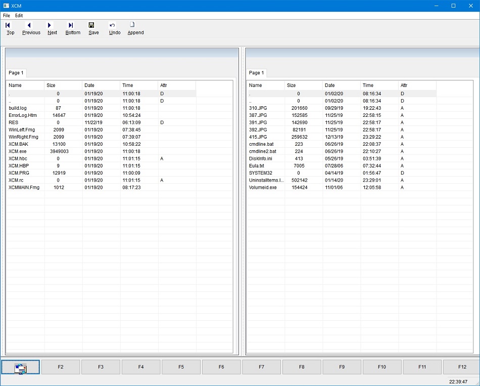

got it working so far
here first Version of HBFM which show some Problem.
HBFM001.zip
(1.26 MiB) Downloaded 329 times
STATUSBAR : you see just TIME() but when maximize you see hole Statusbar.
SPLITBOX : it seem there ist "no End" on right side.

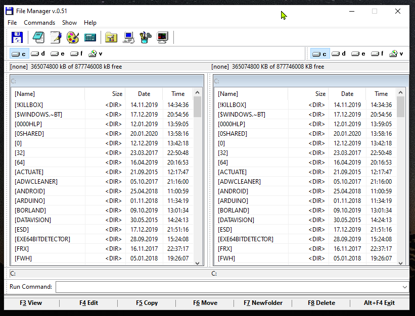

have search for "GetVolumeInformation" and found c:\MiniGUI\SAMPLES\Advanced\FileMan\ :D
so work is done ... but i want my "own" Version.
but now i have a Source where i can look and those HB_FUNC from MiniGUI can also used in HMG
so my Version will be a HMG Version ...

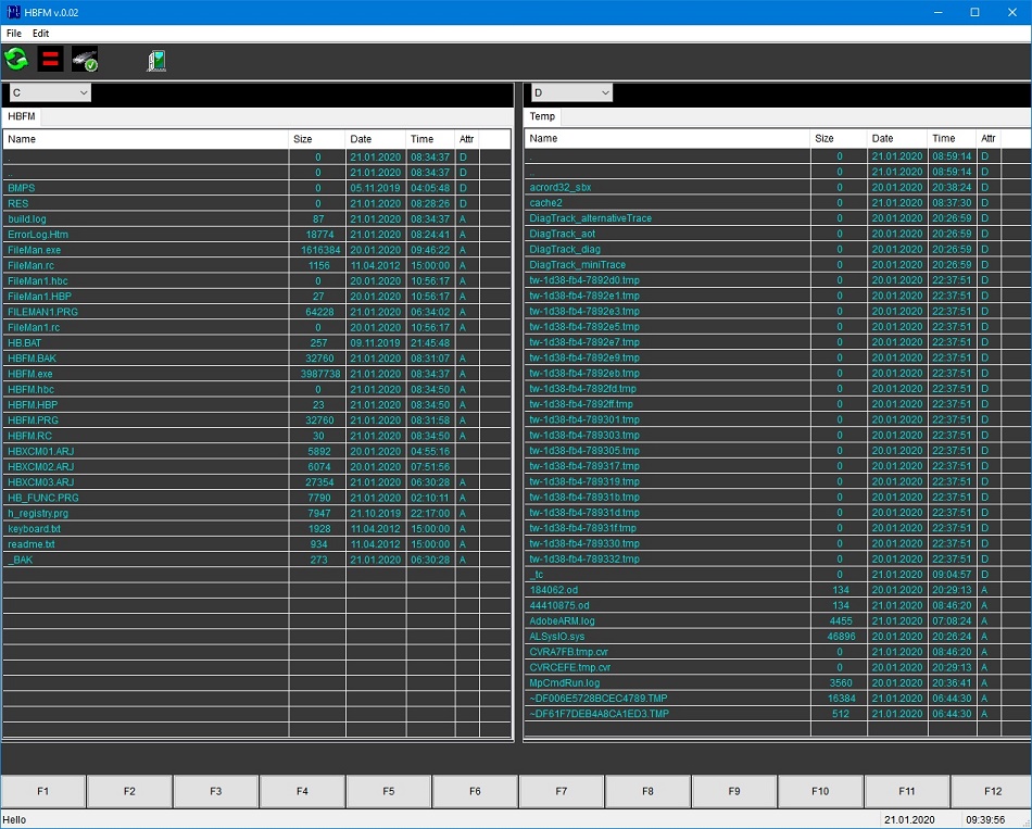

as i say i found a Sample in MiniGUI. it also use SPLITBOX but it does not work fine ...
same Direction now my Question : BACKCOLOR of SPLITCHILD ?
   DEFINE WINDOW Win_1 ;
              MAIN ;
              BACKCOLOR {056,056,056} ;
      DEFINE WINDOW Win_Mid ;
              AT 70, 0 ;
              WIDTH nWidth HEIGHT nHeight - 080 ;
              TITLE '' ;
              PANEL
         DEFINE SPLITBOX
            DEFINE WINDOW WinLeft ;
                    WIDTH 630 HEIGHT 890 - 080 ;
                    TITLE ""   ;
                    SPLITCHILD ;
                    FOCUSED ;
                    NOCAPTION ;
                    BACKCOLOR {056,056,056} <- CRASH
when i try set BACKCOLOR in SPLITCHILD it crash ... so how to set Background-Color :?:
you can see the SPLITBAR which height is limited from Win_Mid which is a PANEL
Combobox are AT 0,0 on WinLeft / WinRight and these Area i like to have "Dark"
who have a Idea to get Color into these Area :idea:

Hi Jimmy,
do you want reinvent the wheel?
[image]
[/image]
This project is present in Minigui Extended edition at least since 2012.
See \Minigui\SAMPLES\Advanced\FileMan
But if you want to improve it, have fun!
Pcmodula

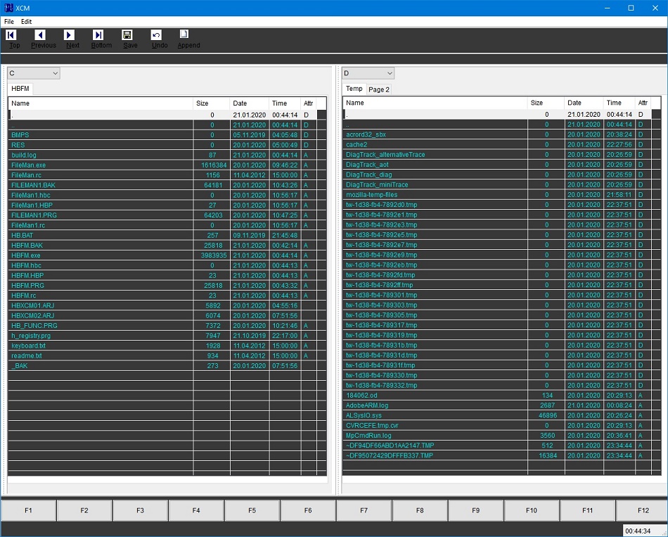

Re: NC Clone
Pcmodula wrote: Tue Jan 21, 2020 6:27 am do you want reinvent the wheel?
this is the Sample i found when search for "GetVolumeInformation" in c:\MiniGUI\SAMPLES\Advanced\FileMan\
it is easy to use existing Code and modify it but i want to learn how it work.
1.) use a VIRTUAL GRID and change Array "on-fly" when change Directory (working)
2.) resize on PC an Table PC ( Landscape / Portrait )
3.) integrate own OSK
4.) Dark-Mode
i notice that MiniGUI Sample does not maximize, so the Work was (again) to write Code for ON SIZE / ON MAXIMIZE
i have try to use SPLITBOX but it is not what i use as CLASS under Xbase++ ... it is a ReBar :o
those things i have to learn and that why i try to "re-engine" my Xbase++ Code under harbour / HMG
Source for c:\MiniGUI\SAMPLES\Advanced\FileMan\ is a BIG help.
