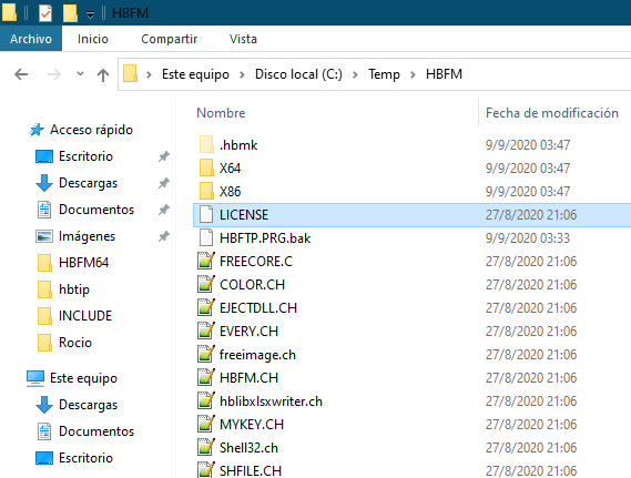

Hi Jimmy
download the version HBFM from Github to see where the FTP connection error is generated but when trying to compile it does not find os.ch in
*+ Source Module => c:\hmg.3.4.4\0\HBFM\\HBEJECT.PRG
*+    Copyright(C) 1983-2020 by Auge & Ohr
*+    Functions: Procedure HBEJECT()
*+               Function EjectMedia()
*+               Static Function CreateVolHandle()
*+               Static Function LockVolume()
*+               Static Function DismountVolume()
*+               Static Function AutoEjectVolume()
*+               Static Function UnlockVolume()
*+               Static Function CloseVolume()
*+               Static Function PreventRemovalOfVolume()
*+               Static Function USB_DeviceColor()
*+               Static Function DO_DeviceImage()
*+               Static Function Do_DeviceAction()
*+               Static Function FillDeviceGrid()
*+               Static Procedure SayInfo()
*+    Reformatted by Click! 2.05.30 on Aug-28-2020 at  1:52 am
#include "HMG.ch"
#include "common.ch"
#include "os.ch"
#include "dll.ch"
#include "EJECTDLL.CH"
#include "HBFM.CH"
2020-09-09 04_02_19-Window.png (30.18 KiB) Viewed 10227 times
