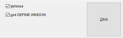

Modification in v2.05.34 for HMG \Source work but it look not nice with "normal" Syntax.
So I add option in CLICK whether to indent DEFINE WINDOW or not
Upgrade is just CLICK.PRG so you need last full Version.
CLICK20535.ZIP
(26 KiB) Downloaded 918 times
