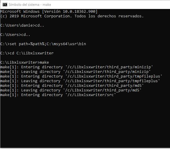

Jimmy:
Download Libxlsxwriter from the GitHub repositories.
install msys64
in windows run CMD
2020-07-09 23_22_52-Libxlsxwriter.png (20.17 KiB) Viewed 10151 times
DLL and .a were generated
2020-07-09 23_32_33-lib.png (4.97 KiB) Viewed 10151 times
libxlsxwriter.rar
(889.57 KiB) Downloaded 280 times

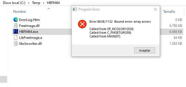

Posted: Fri Jul 10, 2020 7:52 pm
2020-07-10 16_51_02-Window.png (14.81 KiB) Viewed 9840 times
Re: NC Clone
Posted: Fri Jul 10, 2020 9:47 pm
by AUGE_OHR
hi
try
del %APPDATA%\HMG\FMSETUP.*
Re: NC Clone
Posted: Fri Jul 10, 2020 11:11 pm
AUGE_OHR wrote: Fri Jul 10, 2020 9:47 pm
:D Run !!!
