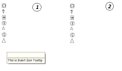

rathinagiri wrote:Regarding the tooltip I didn't understand about the space you have mentioned. The sample is working fine for me in Sumathra.
When icons placed vertically and successive, tooltips not seen other than last one:
Vertically placed icons
1: Cursor is on last icon; 2: Cursor is on first icon.
In fact tooltip come, but for a very short duration; seen as not came.

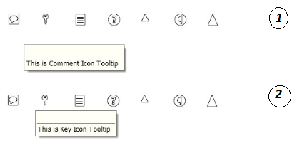

When icons placed Horizontally and successive, all tooltips seen:
Horizontally placed icons
1: Cursor is on first icon; 2: Cursor is on 2nd icon.
