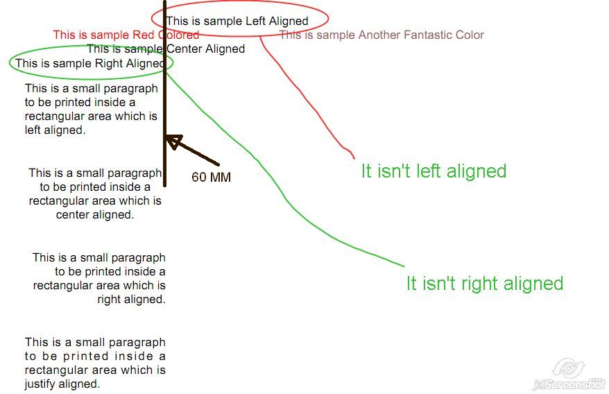

But when creating a sample, paragraph which has to be center aligned was not in the middle of page, and paragraph right aligned was on the left side...
What's going on?
Hi Marek,
Can you please give the exact command you have entered?
It is really not a mistake/bug. :)
Please see the commands for these output.
@ 10, 60 HPDFPRINT 'This is sample Left Aligned'
@ 20, 60 HPDFPRINT 'This is sample Center Aligned' CENTER
@ 25, 60 HPDFPRINT 'This is sample Right Aligned' RIGHT
Note the column coordinate. It starts at 60. So, the text is left/center/right aligned to 60 MM. See this image:
For true alignment, You can check,
@ 10, 10 HPDFPRINT 'This is sample Left Aligned'
@ 20, 105 HPDFPRINT 'This is sample Center Aligned' CENTER
@ 25, 210 HPDFPRINT 'This is sample Right Aligned' RIGHT
You can check differently
@ 10, 105 HPDFPRINT 'This is sample Left Aligned'
@ 25, 105 HPDFPRINT 'This is sample Right Aligned' RIGHT

I apologize for my carelessness
regards, Marek
Oh. No need to apologize Marek. It helped me to double check.
