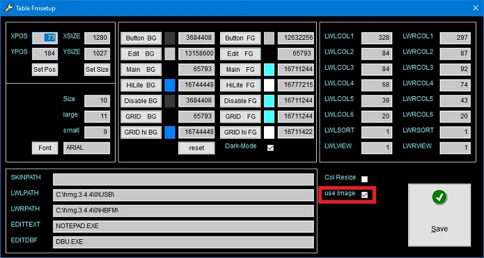

attached Version v0.73
HBFM073.zip
(1.81 MiB) Downloaded 241 times
when start v0.73 it will upgrade FMSETUP.DBF and use a new Directory
GETENV( "APPDATA" ) + "\HMG" -> c:\Users\YourName\AppData\Roaming\HMG\FMSETUP.DBF
if upgrade make Problem i have include FMSETUP.ZIP
Note : all my HMG Tools will use that Directory and Settings e.g. Color
fixed :
FMSETUP.DBF Bug when not "upgrade"
new :
System-Icon using BT_DirectoryInfo() ( THX to Dr. Claudio Soto )
add Field USEIMAGE -> Setup -> Checkbox UseImage
Directory for FMSETUP change to GETENV( "APPDATA" ) + "\HMG"
ALT-F7 with "normal" search (and Everything if installed )
OSK.EXE on Toolbar
"Enter" on Toolbar for Touch-Screen
known Problem :
when ShellOpen a File on TAB > 1 Grid will not "refresh"
Combobox "open" with Mouse ( work well with Keyboard)
TAB-Key with TAB > 1 to change focus to other side
only F1-F11, Crtl-T and Crtl-U are working under TAB > 1
