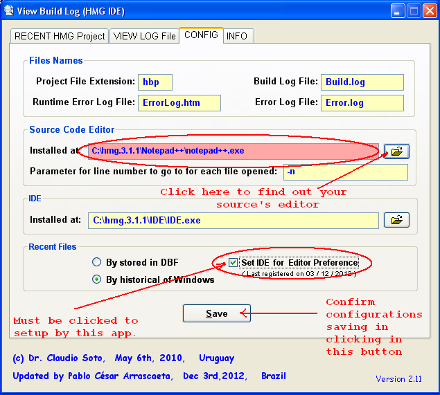

View_Build_Log work with recent files and own accessed prg files stored in database file. You can set your HMG IDE to store your last project modifications accessing by double click loaded at IDE for source editor.
You can set HMG IDE in two ways:
1st Option:

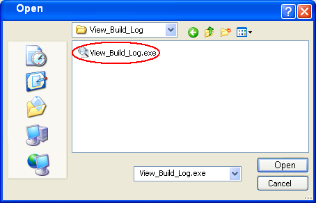

Execute HMG IDE, go to tools menu, click in Preference sub-menu and you will change “Module Editor” which it use to call your source editor of you preference. You can use same source editor but this time will be thru View_Build_Log. So click in the button as showing below:
After choosing View_Build_Log.exe as your source editor, you will need to confirm your favorite source editor in tab CONFIG of View_Build_Log.
2nd Option:
Execute View_Build_Log.exe in tab CONFIG let your favorite source’s editor setted as mentioned below and click in “Set IDE for Editor Preference” as showing below:
View_Build_Log offer others possibilities as:
- When you click in a project with compile error, you can edit PRG at line of error shown.
- You can also view Error.log and ErrorLog.htm which is a runtime error.
- At combobox you can choose for open project folder, run executable project file and load project with HMG IDE.

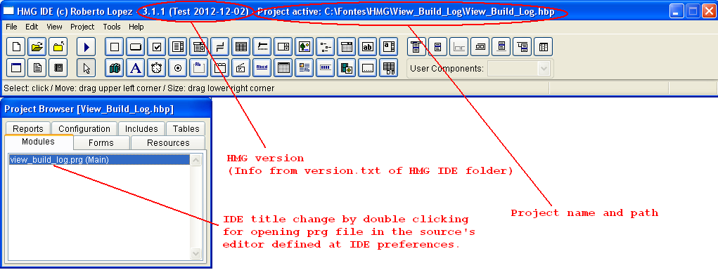

- At the time you clicking on a PRG file at HMG IDE (after CONFIG settings) you will be enable to store all accessed files of your projects. This also could be listed at main grid as recent file by dbf. When you make click on a PRG file on HMG IDE, View_Build_Log will store data access file, change HMG IDE title (with HMG version + Path and project name open) and also it will call your source's editor defined in preference.
