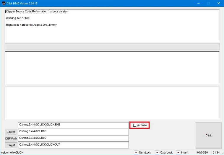

here now lastes Version 0.18
hb_click017.zip
(60.43 KiB) Downloaded 484 times
fixed : LFN (instead of 8.3) Support
change : now include path for DBF
add : Checkbox "Verbose" which can be used "on-fly" to speed up
if "underflow" or "overflow" now display YesNo Box.
it is recommend to BREAK loop with "Yes" ... but sometimes it still fail
i do my best but i can't "Guarantee" that it produce right Code with "your" Source :!:
so i include Source and everbody can look into it how it work.
please send me a (small) Sample if you found a Problem ( HMG Snytax still not include in this Version), thx
