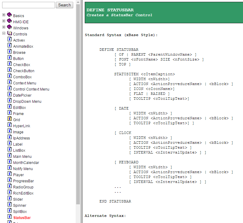

Posted: Tue Jan 10, 2017 9:51 pm
Hi Claudio, Rathinagiri and all,
This is to advice there is not any instructions in HMGDOC for StatusBar with following properties:
In Standard Syntax (xBase Style):
  • BOLD
  • ITALIC
  • UNDERLINE
  • STRIKEOUT
Or at Alternate Syntax:
  • FONTBOLD
  • FONTITALIC
  • FONTUNDERLINE
  • FONTSTRIKEOUT
These properties surely works in StatusBar, but not documented: then many people do not know that exists... :?
Could it be included for next HMG release ? (..\DOC\data\StatusBar.htm)
Posted: Tue Jan 10, 2017 11:35 pm
by srvet_claudio
Pablo thanks for the info
