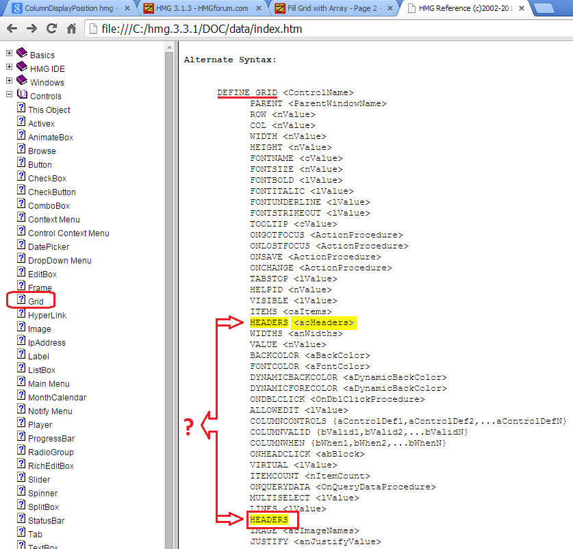

Hi Rathi, ( SOLVED ) I have found difficulties to get proper information at \Controls\Grid I was looking for NOHEADERS property for Alternate Syntax and according to local C:\hmg.3.3.1\DOC\hmgdoc saying just HEADERS wrongly (see below image):
This second HEADERS should be replaced by SHOWHEADERS <lValue>

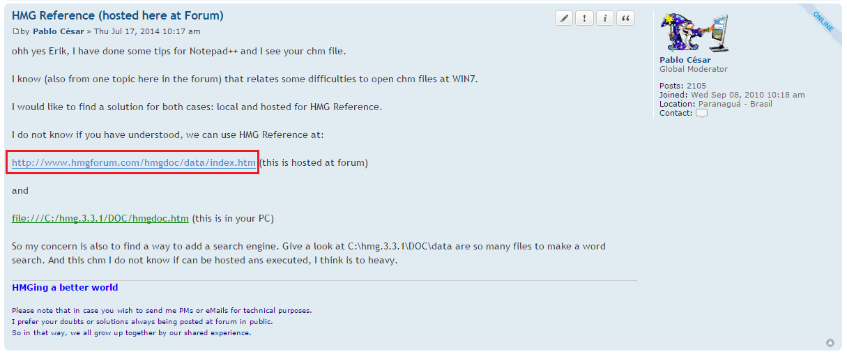

( PARTIALLY SOLVED ) I have another question: The hmgdoc/data/index.htm (this is hosted at forum) is not any more in our forum ?
Probably something was lost at "Forum updated to PHPBB 3.1.0" ?
