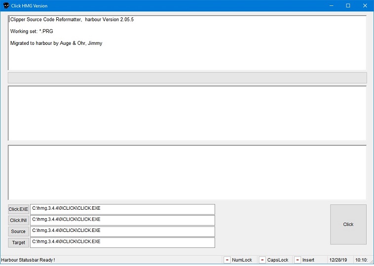

have add TextBox for "Input"/"Output" of Source/Target but not finish yet.

got it run in GUI Mode with different Directory for Source / Target
after Start CLICK.EXE it will create CLICK.INI
i have change to RUNMODE=S87 and VERBOSE=YES
if you want it Quick use VERBOSE=NO
so here is CLICK.EXE

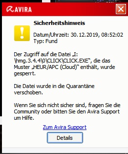

when copy to USB-Stick i got this Anti-Virus Message
perhaps it is while i have used UPX.EXE :?:
it is NOT a VIRUS :!:
