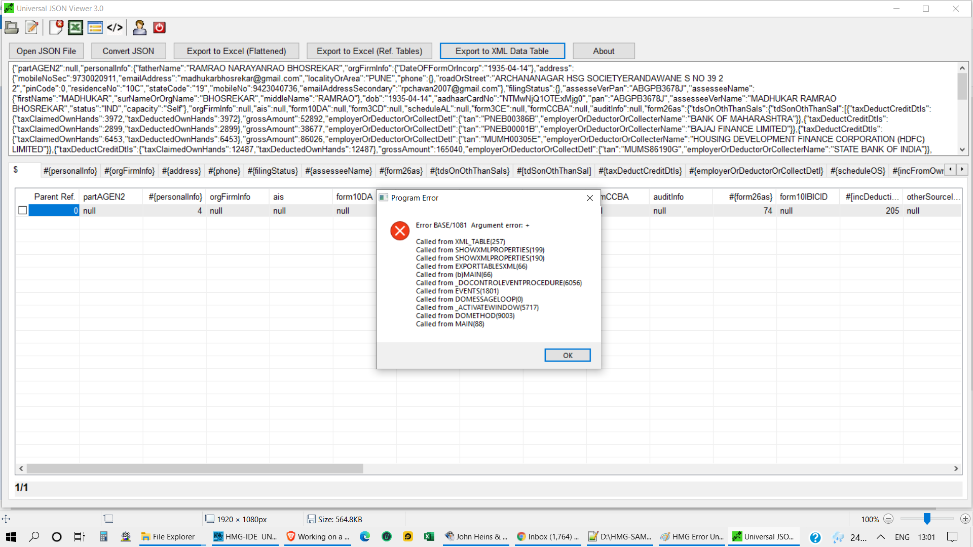

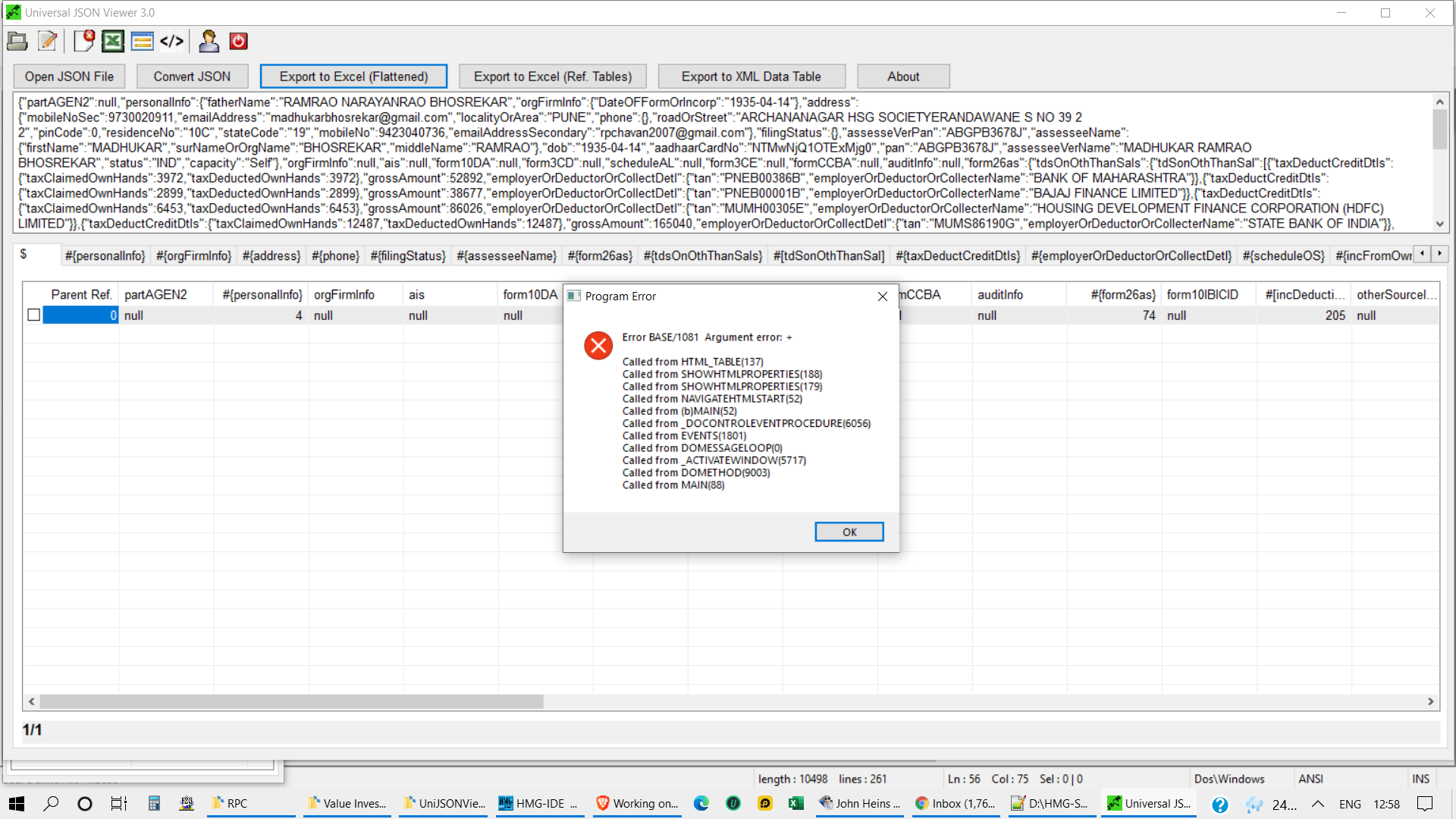

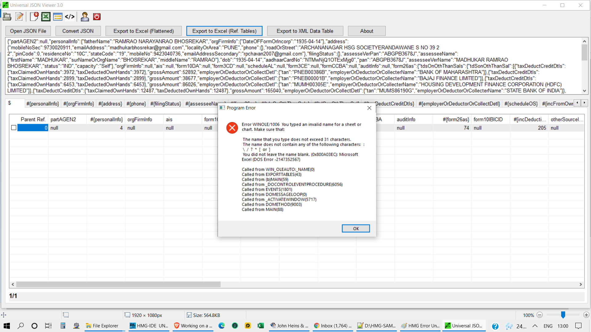

Hi Rathinagiri
I am trying to use HBJson/UniJsonViewer to convert Json file to Excel file. I am getting following errors.
When I try to convert to Excel(Flattened)
HMG Error UniJason2XL(Flattened).png (564.84 KiB) Viewed 5974 times
When I try to convert to Excel(Ref Tables)
HMG Error UniJason2XL(RefTable).png (571.84 KiB) Viewed 5974 times
When I try to convert to XML
HMG Error UniJason2XML.png (558.89 KiB) Viewed 5974 times

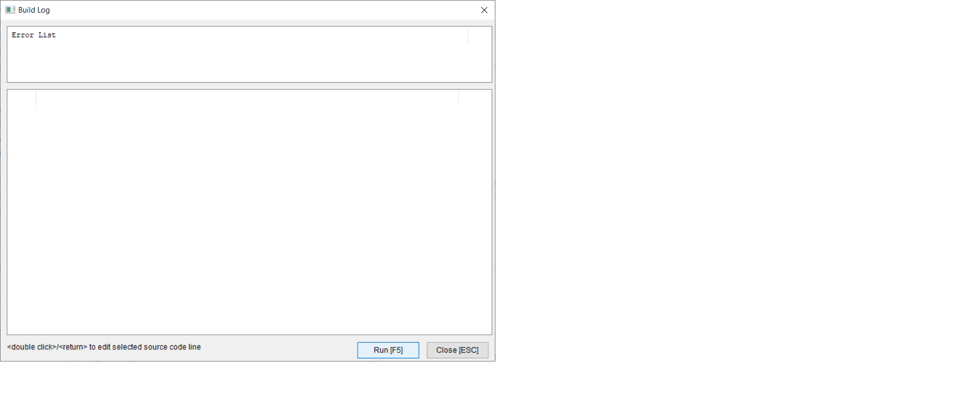

Finally I tried to compile json.hbp and got following blank screen.
HMG Error HBJason.png (22.95 KiB) Viewed 5974 times
I think Sudip has reported the same blank screen in immediate above post.

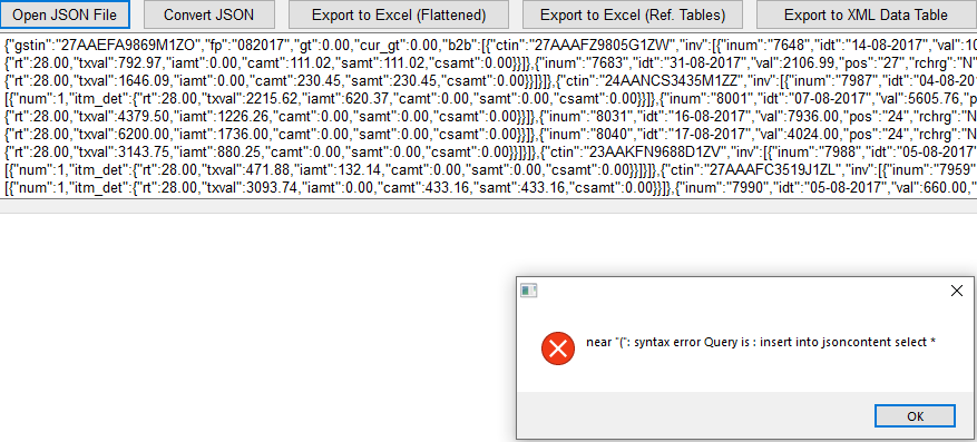

by jayadevu
Hi Rathinagiri,
Thanks for the new Update. Just downloaded the same and compiled. It gives syntax error as seen in the attachement. This is the same json file which you had used in version 2. I had the same difficulty in Version 2 also. Please check.

by RPC
Hi Rathinagiri sir
I am still getting blank screen on compilation as shown in my post earlier.
I am using HMG 3.4.4 my os is win 10 x64
