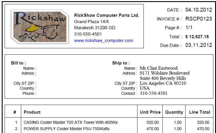

Posted: Thu Oct 04, 2012 10:22 am
Hi
A new version of HPdfDemo :)
Added:
  • - a table : COMPANY ( hard coded company info removed )
    - an option : WayBill
    - VAT
    - Multiple pages
Changed : some cosmetics
Pleas note that hmg_hpdf.Prg is slightly different than original.
Enjoy :D
Screen shoot of HPdfDemo 2012.10.04
HPdfDemoCA04.zip
Source files and test tables of HPdfDemo 2012.10.04
(104.38 KiB) Downloaded 430 times

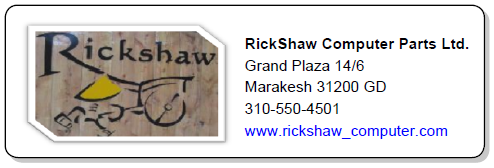

Posted: Thu Oct 04, 2012 10:33 pm
rathinagiri wrote:...Implemented Rounded Rectangle...
Tested, works perfect :arrow:
Again, thanks a lot :)
Also tried a shadow effect by adding (by courtesy of author) two new HPDFPRINT commands :
#xcommand @ <Row>, <Col> HPDFPRINT ERASE TO <ToRow> , <ToCol> ;
_HMG_HPDF_RECTANGLE ( <Row> , <Col> , <ToRow> , <ToCol> , , 255, 255 , 255 , .F. , .T. , .T. )
#xcommand @ <Row>, <Col> HPDFPRINT ERASE TO <ToRow> , <ToCol> ROUNDED;
_HMG_HPDF_ROUNDRECTANGLE ( <Row> , <Col> , <ToRow> , <ToCol> , , 255, 255 , 255 , .F. , .T. , .T. )
This implementation assume that back-color is WHITE.
Does we can define and query back-color ?
My method for ( rounded ) shadow effect is :
@ nRow + 1, nCol + 1  HPDFPRINT RECTANGLE ;
                       TO ( nRow + 36 ), ( nCol + 111 ) ;
                       FILLED COLOR LIGHTGRAY ;
                       ROUNDED
@ nRow,  nCol  HPDFPRINT ERASE TO nRow + 35, nCol + 110 ROUNDED
@ nRow,  nCol  HPDFPRINT RECTANGLE ;
                       TO nRow + 35, nCol + 110 ;
                       ROUNDED
In HPdfDemo.prg, add this two line at beginning of WriteCompany procedure, after deleting
@ nRow + 1,  nCol + 1  HPDFPRINT RECTANGLE ; ...
command.
HMG PDF Rounded Rectangle and shadow effect
