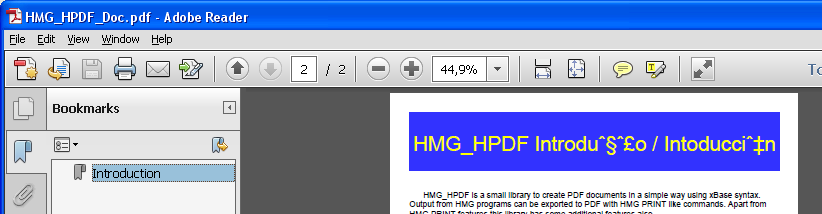

Posted: Mon Jun 03, 2013 9:33 pm
Rathinagiri wrote:Actually, what is your problem?
The problem is not making brazilian or spanish accents (especial characters from the language). I have tested in HMG 3.0.46 and 3.1.3 in UNICODE and ANSI code. But sadly, do not work with accents with harupdf.
This is a code example:
#include "HFCL.CH"
// SET LANGUAGE TO PORTUGUESE
define window main at 0, 0 width 300 height 300 main title 'HMG HPDF Document'
	define button create
	row 100
	col 90
	width 120
	caption 'HMG HPDF DOC'
	action pdf_create()
	end button
	on key escape action thiswindow.release
end window
main.center
main.activate
Return nil

Look at this is wrong characteres displayed:

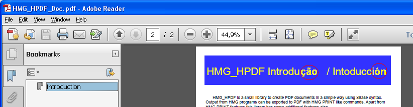

And this is the right ones to be displayed (this was made by PaintBrush):
So it is somthing wrong and now with UNICODE most probably will be so usefull if accents characters could be displayed in good order...

Problema con HaruPDF
Posted: Tue Jun 04, 2013 5:35 pm
Rathinagiri wrote:HMGpdf unicode is not yet supported. We (Claudio and myself) had checked and tried to ANSI version to Unicode and failed. But trying...
Hi Rathi, thanks to clarify this matter. For HMG 3.046 version, we can use SET HPDFDOC ENCODING should it be the right way to set language in this case ?
Re: Problema con HaruPDF
Posted: Tue Jun 04, 2013 6:04 pm
by IMATECH
Just use:
HMG_HPDF_SetEncoding( HPDF_ENCODING_WIN_ANSI )
#xcommand SET HPDFDOC ENCODING TO <cEncoding> => _HMG_HPDF_SetEncoding( <cEncoding> )
#define  HPDF_ENCODING_FONT_SPECIFIC  "FontSpecific"
#define  HPDF_ENCODING_STANDARD       "StandardEncoding"
#define  HPDF_ENCODING_MAC_ROMAN      "MacRomanEncoding"
#define  HPDF_ENCODING_WIN_ANSI       "WinAnsiEncoding"
#define  HPDF_ENCODING_ISO8859_2      "ISO8859-2"
#define  HPDF_ENCODING_ISO8859_3      "ISO8859-3"
#define  HPDF_ENCODING_ISO8859_4      "ISO8859-4"
#define  HPDF_ENCODING_ISO8859_5      "ISO8859-5"
#define  HPDF_ENCODING_ISO8859_6      "ISO8859-6"
#define  HPDF_ENCODING_ISO8859_7      "ISO8859-7"
#define  HPDF_ENCODING_ISO8859_8      "ISO8859-8"
#define  HPDF_ENCODING_ISO8859_9      "ISO8859-9"
#define  HPDF_ENCODING_ISO8859_10     "ISO8859-10"
#define  HPDF_ENCODING_ISO8859_11     "ISO8859-11"
#define  HPDF_ENCODING_ISO8859_13     "ISO8859-13"
#define  HPDF_ENCODING_ISO8859_14     "ISO8859-14"
#define  HPDF_ENCODING_ISO8859_15     "ISO8859-15"
#define  HPDF_ENCODING_ISO8859_16     "ISO8859-16"
#define  HPDF_ENCODING_CP1250         "CP1250"
#define  HPDF_ENCODING_CP1251         "CP1251"
#define  HPDF_ENCODING_CP1252         "CP1252"
#define  HPDF_ENCODING_CP1253         "CP1253"
#define  HPDF_ENCODING_CP1254         "CP1254"
#define  HPDF_ENCODING_CP1255         "CP1255"
#define  HPDF_ENCODING_CP1256         "CP1256"
#define  HPDF_ENCODING_CP1257         "CP1257"
#define  HPDF_ENCODING_CP1258         "CP1258"
#define  HPDF_ENCODING_KOI8_R         "KOI8-R"
SET HPDFDOC ENCODING TO HPDF_ENCODING_WIN_ANSI
or
