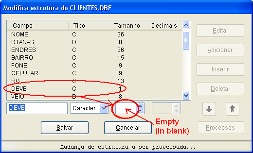

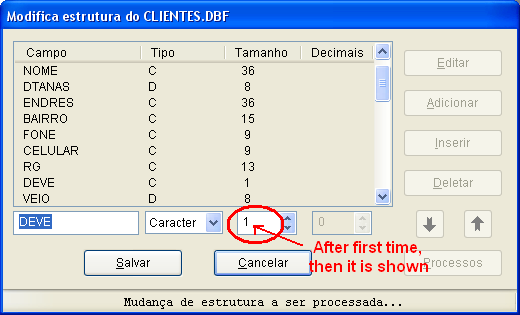

Please, I need help: I found a weird behaviour when double clicked or editing at field with caracter-type and lengh 1. In first editing spinner_1 is showing in blank not like as 1. But if cancel and returning editing then spinner_1 is showing 1. I tried to refresh spinner but it doesn´t work. Very strange. My tries was at line 1530, unsuccefully. :cry:
In the first time I went in to edit, it does not shows the value "1" in Spinner_1:
When is canceled editing and returns for the second time, then yes it appears correctly:
Very strange! :(

Posted: Thu Sep 20, 2012 7:32 pm
Ola Pablo
Pablo César wrote:... a weird behaviour when double clicked or editing at field with caracter-type and lengh 1.
I don't like this word; but this seems a bug :(
A second oddness is : if changed
1063        RANGEMIN 1
to
1063        RANGEMIN 0
problem gone away; but this modification is also wrong. You have validate spinner value to avoiding 0 though allowed by spinner.

Posted: Fri Sep 21, 2012 12:45 am
Yes, your completly right: It´s a bug ! And I will post this message in HMG Bug Reports section !!
esgici wrote:A second oddness is : if changed
1063        RANGEMIN 1
to
1063        RANGEMIN 0
Problem gone away; but this modification is also wrong. You have validate spinner value to avoiding 0 though allowed by spinner.
Ohhh guy ! You are very clever ! Thank you very much ! I have already validate bigger than zero in Spinner_1.
