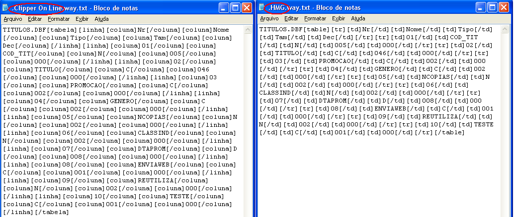

What I tried to say is: in that option 4, you can use /CLIP option just for clipboard proposes. But if in that moment, your browser is open in "Clipper On Line" site (http://www.pctoledo.com.br/forum/index.php) then the contents of strings of structure for copying in clipboard will be done in other format (not as is on the screen, will be in BBCode format, especifically in [ table ] way) and will be copied like this:
TITULOS.DBF[table][tr][td]Nr[/td][td]Nome[/td][td]Tipo[/td][td]Tam[/td][td]Dec[/td][/tr][tr][td]01[/td][td]COD_TIT[/td][td]N[/td][td]005[/td][td]000[/td][/tr][tr][td]02[/td][td]TITULO[/td][td]C[/td][td]046[/td][td]000[/td][/tr][tr][td]03[/td][td]PROMOCAO[/td][td]C[/td][td]002[/td][td]000[/td][/tr][tr][td]04[/td][td]GENERO[/td][td]C[/td][td]002[/td][td]000[/td][/tr][tr][td]05[/td][td]NCOPIAS[/td][td]N[/td][td]002[/td][td]000[/td][/tr][tr][td]06[/td][td]CLASSIND[/td][td]N[/td][td]002[/td][td]000[/td][/tr][tr][td]07[/td][td]DTAPROM[/td][td]D[/td][td]008[/td][td]000[/td][/tr][tr][td]08[/td][td]ENVIAWEB[/td][td]C[/td][td]001[/td][td]000[/td][/tr][tr][td]09[/td][td]REUTILIZA[/td][td]N[/td][td]002[/td][td]000[/td][/tr][tr][td]10[/td][td]TESTE[/td][td]C[/td][td]001[/td][td]000[/td][/tr][/table]
This format I made just to be easier way for poster of "Clipper on Line" when needs to make a new post with dbfs structures being shown in table way. The only problem to be fixed is that we have to translate BBCodes utilized in "Clipper on Line" site is tabela in place of table, linha in place of tr and coluna in place of td. Then you can change in code for php ressources uses in English way not like in Toledo way that he has created his own command (in php) for table proposes.
I hope to been clearly now. For translations, sorry if is not so clear. Yesterday I have used Google Translator just to post this last function of modifying structures in a harry.
This STRU.exe was my first app beeing created in HMG in February of 2011 but it was without modi_stru functions.
Next step, I will apply a new function of edit data of dbf. And finally translations of English and possible in Spanish too.
And thanks all of you good people ! Yours praises are very good wellcome ! Your good words make me work better ! Sharing is a good way to return yours contributions and this include all whom makes a xBase language even more better ! Thank to the creator of Roberto without him we will not be here...
In codes way, please compare actual results of STRU and what it will be do for php in HMG site (click on image below to see better resolution):

By the way your last image Screen35.PNG is invisible :( Why you used foreign place (dc627.4shared.com) instead of attachment feature of our forum ?
esgici wrote:
Pablo César wrote:...What I tried to say is: in that option 4...
No problem amigo, I want only better understanding ;)
Yeah, very good question, thanks for your participation.
In other hand this forum and ours both are Powered by phpBB; CLIP and other features must be same in both forum.
Yes, I think so too. I will suggest to Mr. Toledo to put both ways.
Anyway no problem, your program is good. Reminded me that oldy goldy days: In dot prompt Enter command DISP STRU or MODI STRU
Yeah, this was my inttention. Also for who programate in dot prompt, also usefull.
By the way your last image Screen35.PNG is invisible. Why you used foreign place (dc627.4shared.com) instead of attachment feature of our forum ?
Thank you to advise me for that feature. I already correct it. But please tell me if is possible to put a visible image attached in the middle of message. It is possible ?
