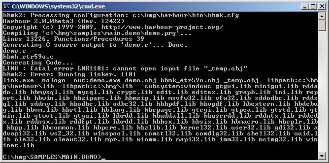

I am not sure where I did mistake, but I got compilation error.
IDE is also not working (compilation). May be you will correct it later. And I only want to inform you about my test.
With best regards.
Sudip

Rathi, I guess I have done some mistakes :(
I uninstalled version 2.9.5. Deleted C:\HMG folder. Then installed HMG 3.0.0.
Then I restarted computer. Went to command prompt. CD C:\Samples\Main.Demo folder. Then typed COMPILE DEMO.
There must be something which I missed ;)
Please help me if you find any mistake in my steps.
Thanks in advance.
With best regards.
Sudip

sudip wrote:...
Hello Sudip,
You have a path to BCC in your environment.
Please be so kind to update your local hmg\batch\compile.bat as below:
@echo off
rem ***************************************************************************
rem HMG 3.0 Compile batch.
rem Roberto Lopez (2009.10.10)
cls
set path=C:\hmg\HARBOUR\comp\MINGW\bin;%path%
rem set default resources
I hope that helps :idea:

Hello Grigory,
gfilatov wrote:...
@echo off
Thanks a lot. :D My problem was solved.
With best regards.
Sudip
