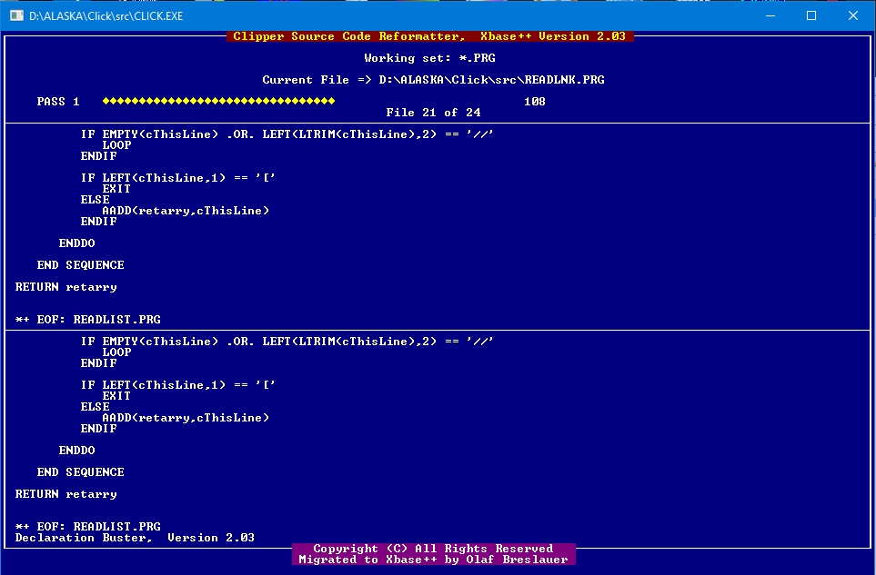

hm ...
i just saw that my Xbase++ Version show "more" than harbour Version
the lower Part is not visible under harbour ... can this made it so slow :?:
