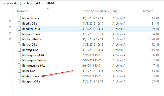

danielmaximiliano wrote: Sat Aug 31, 2019 10:01 pm
under c:\hmg.3.4.4\LIB-64\ i did not LIBhmg-64.a ... where do i get it :?:
p.s. what about LibLibPq.a ... is there a LibLibPq-64.a :?:
Try Unicode

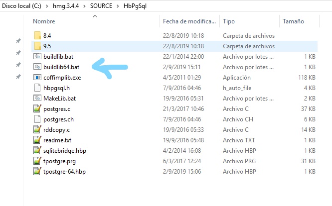

Re: LIBhmg-64.a / LibLibPq-64.a
Posted: Mon Sep 02, 2019 6:25 pm
Unrar To
C:\hmg.3.4.4\SOURCE\HbPgSql
HbPgSql.rar
(152.97 KiB) Downloaded 688 times
Exec
buildlib64.bat
Exec .jpg (203.26 KiB) Viewed 27095 times

danielmaximiliano wrote: Mon Sep 02, 2019 6:25 pm Unrar To
HbPgSql.rar
Exec
buildlib64.bat
