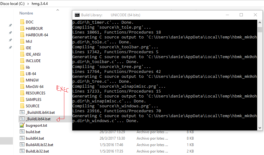

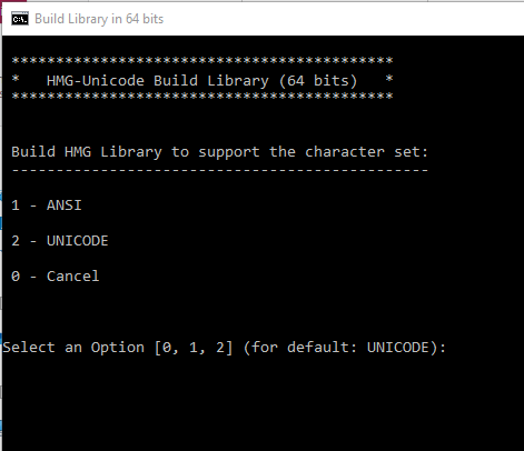

under c:\hmg.3.4.4\LIB-64\ i did not LIBhmg-64.a ... where do i get it :?:
p.s. what about LibLibPq.a ... is there a LibLibPq-64.a :?:
Try Unicode
2019-08-31 18_56_47-Window.png (7.56 KiB) Viewed 32965 times
