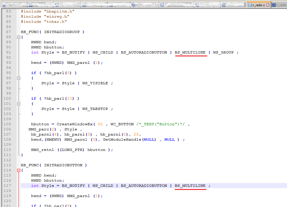

Hi Krzysztof and Eduardo.
Sorry, Krzysztof. Nothing missing is the same code I have, but... now I remembered that I had left more this BS_MULTILINE style in the functions: INITRADIOGROUP, INITRADIOBUTTON and SETRADIOSTYLE of the HMG source code. It had done in test character and ended up staying.
But now even removing and in trying to set style with BS_MULTILINE does not work the same way as when the RadioGroup is started. :|
I have no idea how to solve it. All tests I just done, doesn't work as being native of HMG function with plus this BS_MULTILINE.
Here's the executable file to be tested at yours:
Demo1.rar
Executable Demo with MULTINE in the HMG core
(1.24 MiB) Downloaded 274 times
It may would be solved if Claudio would accept BS_MULTILINE as more one property in the RadioGroup Style.
Anyway with ITEM_HEIGHT as 28 or handled higher, MULTILINE remains a necessary property and without prejudice.
Could it be done this Claudio ?

@ Claudio
Resumiendo, quiero preguntarte:
  1. Que es lo que contiene (sé que es valor numérico) pero a que se refiere _HMG_SYSDATA [ 183 ]  ?
    _HMG_ActiveFrameRow based _HMG_FrameLevel, qué seria esto ? Un orden herarquico de los objetos ?
  2. Cuando un RadioGroup puede alcanzar a tener un valor diferente a: _HMG_SYSDATA [ 23 ] [x] == -1 ?
  3. Ya que el comportamiento es estraño al intentar colocar BS_MULTILINE (no obedece como deberia o al menos no sé si estoy haciendo algo mal) al estilo del RadioGroup.
    Por lo tanto sugiero incluir más un estilo (BS_MULTILINE) fijo en las funcion en C del RadioGroup, puede ser ?
Googled
In short, I want to ask you these questions Claudio:
  1. What does it contain (I know it is numerical value) but what does _HMG_SYSDATA [183] refer to ?
  2. When a RadioGroup can reach a value other than: _HMG_SYSDATA [23] [x] == -1 ?
  3. Since the behavior is strange when trying to put BS_MULTILINE (does not obey as I should or at least I do not know if I'm doing something wrong) in the style of RadioGroup.
    So I suggest including more a style (BS_MULTILINE) fixed in the C function of the RadioGroup, can it be ?
