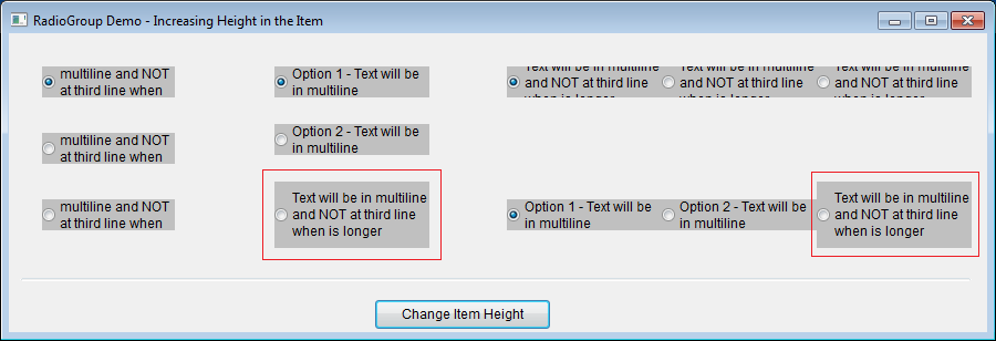

Is it possible to increase height of item programmatically ? May you teach us how to do it, please ?
As you can in third item in red marked, it is not display for complete.

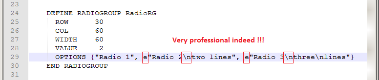

Maybe in this way:

    DEFINE RADIOGROUP RadioRG
      ROW      30
      COL      60
      WIDTH    60
      VALUE     2
      OPTIONS {"Radio 1", e"Radio 2\ntwo lines", e"Radio 3\nthree\nlines"}
    END RADIOGROUP

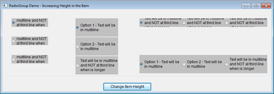

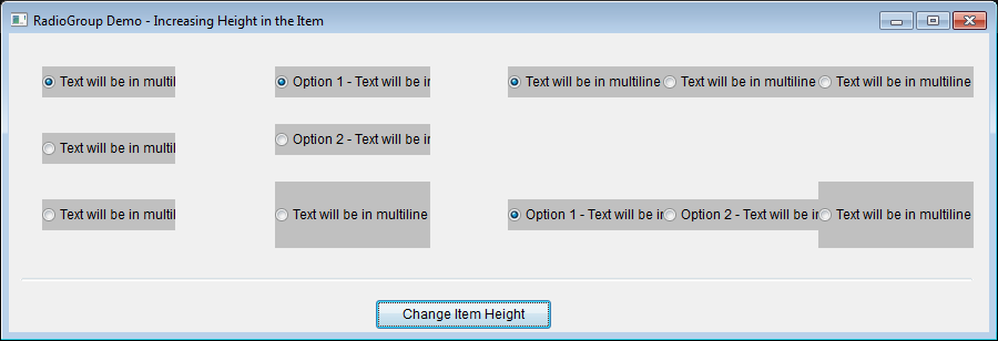

I got something different. I did this a couple of hours ago and I was late to post on time while having my afternoon coffee ... sorry Krzysztof hopefully if this my message seems redundant but still think it is never late to show other ways to do. Do not you think ?
I really liked the way you do it, Krzysztof. Very creative by the way.
I did it this way I can work with RadioGroup horizontally as well. However, changing the spacing between the items and changing height and width has its consequences. The way I do it requires the user to discern all factors involved. Otherwise everything is weird and unfeasible.
The important thing to succeed in the result, attached what I had achieved:
RadioGroupMultiLine.rar
Source files
(1.8 KiB) Downloaded 258 times
My code is not finished. I know it can be done better.
Many thanks Krzysztof for your excellent and impeccable work.
I loved the use of ClientAreaHeight based on the size of the Frame in it.
Awesome !

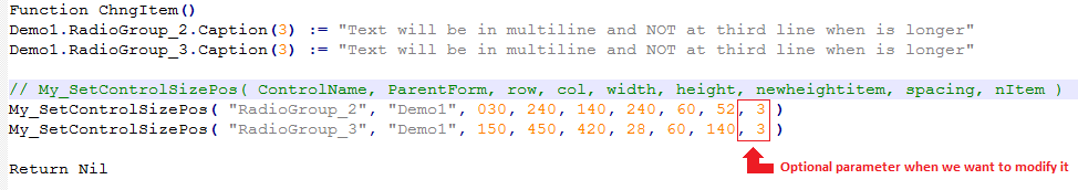

I ended up forgetting to mention about the 9th optional parameter which is the number to which you want to change only.
Re-remembering that the 8th parameter should also must be changed.
Because the combination of these factors changes the layout of RadioGroup in a sometimes radical way.
Here's the little changed code:
Source files
(1.85 KiB) Downloaded 251 times
I think this code is only useful in cases where the text size of RadioGroup items does not change at all times. I mean that even if of different sizes, they are always of the fixed size. Not the same as OptionBox, for example.
I hope it's educational and funny... :D
PS: The gray backcolor of RadioGroups is just to duly denote size and position of each item.
