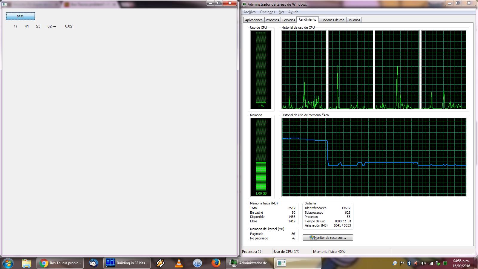

Sadly, the problem remains here (Windows 7 Pro 32 bits).
The program generates 467 images, being the last a black one.
I'm attaching the first image and the 466th.
I've changed the main window in the demo to topmost and shred the desktop between it and the task manager showing system memory usage.
Capture #1:
Capture #466:
