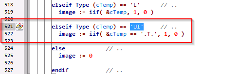

Hi Claudio,
I also developped a way to add a checkbox column to the browse control (to select records).
2017-01-09 23_58_36-Lijst facturen.png (2.3 KiB) Viewed 7642 times
This requires a little (harmless) addition to de h_browse.prg (2 lines).
2017-01-09 23_53_46-h_browse.prg - SynWrite.png (6.92 KiB) Viewed 7642 times
Maybe you can consider to add this small modification to the next release.
I can create a small demo for the HMG community (if there is interest) to demonstrate the checkbox column.

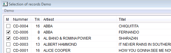

Here is the demo program with selection function in the browse control (see attachement).
2017-01-12 22_29_40-Selection of records Demo.png (10 KiB) Viewed 7564 times
Like posted earlier, to use the selection functionality the program requires a little (harmless) addition to de h_browse.prg HMG source code (2 lines).
2017-01-09 23_53_46-h_browse.prg - SynWrite.png (6.92 KiB) Viewed 7564 times
Records can be selected and unselected by double clicking the checkboxes, using the menu or using the CTRL-F12 key combination. The key combination CTRL-F12 also moves the cursor to the next line, to make it easyer to select multiple records.
Enjoy :D
Theo

Re: BROWSE: problem with events key K_UP, K_DOWN ..
Posted: Sat Jan 14, 2017 10:53 am
by trmpluym
Hi Mustafa,
Thanks for your reply. Your solution works great for a grid in a single user environment.
I hope i do not offend you, but it does not work well in a multi-user environment.
In a multi-user program i am currently developing i was looking for a solution to select multiple records (for example to delete, print or copy the selected records).
A grid works very slow in combination with a DBF source in a multiuser environment ( see: http://www.hmgforum.com/viewtopic.php?f=5&t=5056 ).
But there is another problem when using your example in a multi user environment. The selection is stored in the DBF (the field STOCK->L ). When one user selects a record and the next user opens the application the same record is also selected.
This can be fixed easy using an array as a source for the selection (if you like a can post an example). But still the speed problem remains in a multi user environment.
So i created a solution for the faster working browse control when using a DBF. I could not find any checkbox selection example on the forum so i decided to write my own and share it over here.
But again i hope you do not take my post as an offend. The opposite is a fact, i discovered your checkbox grid solution in search for my problem before, and it was a very good learning experience !
Theo
