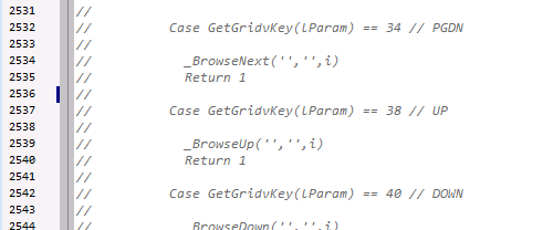

I found a solution for the navigation keys problem with the quick search in the browse control!
My solution also requires modification on the "c:\hmg.3.4.3\SOURCE\h_windows.prg" source (comment out the navigation key lines), see:
2017-01-08 13_29_31-h_windows.prg - SynWrite.png (8.08 KiB) Viewed 6714 times
I use the same lines again in the custom EVENT prcedure (see attachement).
Now the quick search also works after using one of the navigation keys :D
Theo
