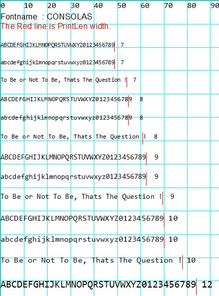

Posted: Tue Jun 16, 2015 10:56 pm
by hmgchang
Dear Masters and Mr. Rathinagiri,
Thanks for the your printlen function.
I experimented and modified your printlen function,
function printLen( cString, nFontsize, cFontname)
  cCreateFont := _HMG_CREATEFONT( OpenPrinterGetDC(), cFontname, nFontSize )
  nGetTextWidth := gettextwidth( OpenPrinterGetDC(), cString, cCreateFont )
	nWidth := nGetTextWidth * 25.4 / 600
	RETURN( ROUND( nWidth, 2))
	*- return round( nGetTextWidth * 0.0254 * nFontsize, 2 )
and the result,
it works but not perfectly, esp with the fontsize 8, any suggestions ?
_FontSizeWidth.zip
(3.41 KiB) Downloaded 319 times
