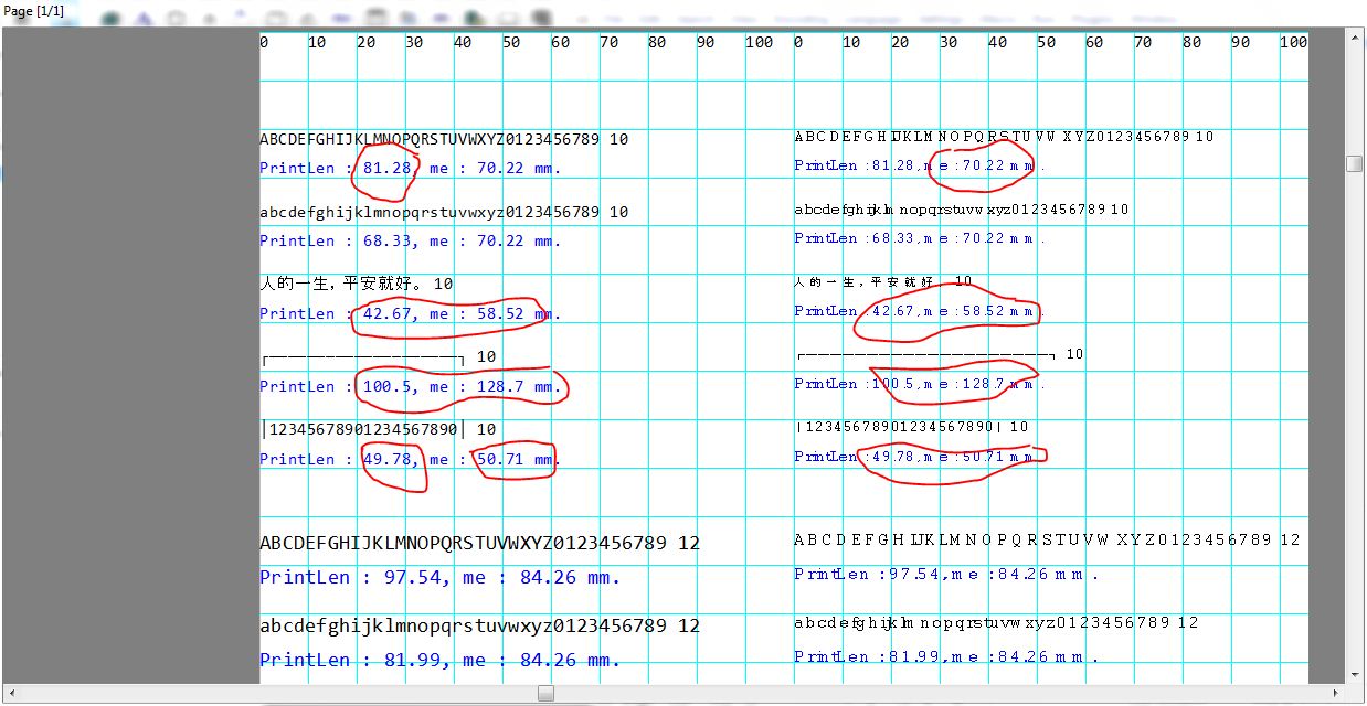

Dear Sirs,
I do some test on PrintLen...
PrintLen on Test.JPG (166.22 KiB) Viewed 6805 times
Both side are for monospace and non-fixed fonts...
BTW, how to tell font is monospace or not ?

Re: PrintLen on Test
I think there is no function to find out.
We can compare with the following box drawing chars. If the box is misaligned it is proportional font. If the box is rightly aligned, then it is monospace.
The following is in monospace font.
┌─┐ ┌┬┐ [example of line drawing characters]
│ │ ├┼┤ [requires fixed-width, especially with spaces]
└─┘ └┴┘ [otherwise they are mis-aligned, as in the bottom.]
Same text, in proportional font.
Thank you Chang for opening this thread.
You are an eye opener!
I have to correct some other programs according to the new calculations.
I have a doubt too.
Why in the picture above, printing in "Courier 10" doesn't have the same width for 'ABCDE...' and 'abcde...'? The font is a fixed width font...

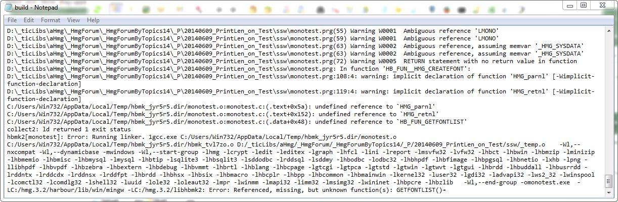

Post by hmgchang »
Dear Sirs,
Thks Mr. Rathinagiri...
i tried by get this error
compile error...
compile error...
Which version of HMG are you using? It compiles right in HMG 3.3.1
Post by hmgchang »
Thks Sir,
I am still using hmg 3.2
And will upgrade ! :)
