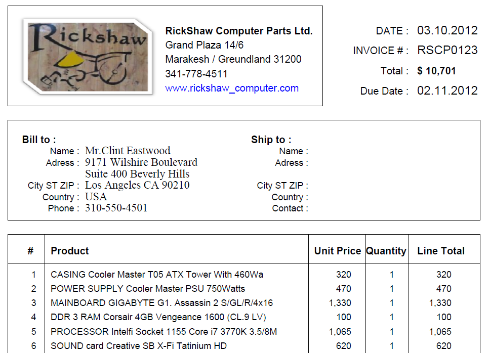

An exercise to build a bill as a .pdf file by using new feature of HMG : HMG_HPDF
Thanks to our Diamond for providing us such great possibility :)
Screen shoot of .pdf file produced by HPdfDemo02
HPdfDemo02.zip
Source and test tables of HPdfDemo02
(198.02 KiB) Downloaded 600 times
Viva HMG, viva Roberto Lopez, viva Sri Rathinagiri !

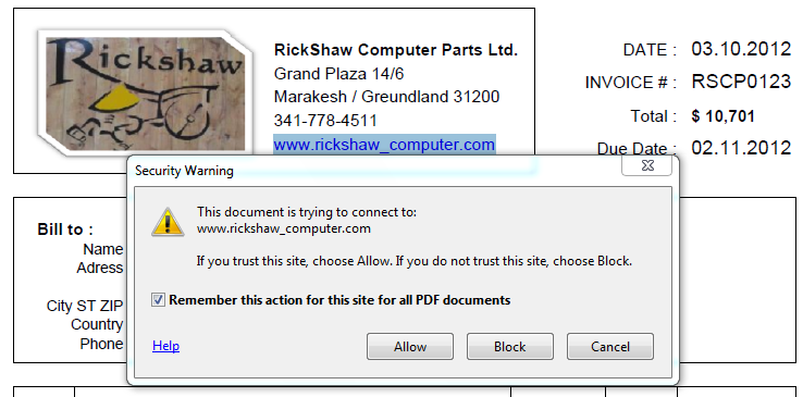

Super Esgici. It is a nice demo for tabulation. I wondered about the web site link being clickable in PDF. :)

Hi Rathi
rathinagiri wrote:...I wondered about the web site link being clickable in PDF. :)
Already it is : :shock:
( Adobe Reader X Version : 10.1.4 )
( Everything is automatic now :( )
URL is clickable !
URL is clickable !
