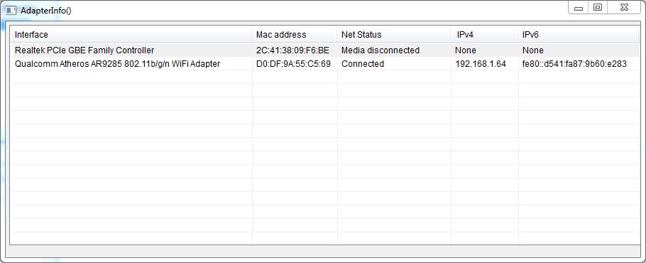

Hola a todos
se agrego al grid la direccion IPv4 e IPv6 de la placa de red conectada a internet que suministra el proveedor o direccion interna dada por el servidor DHCP local.
el GRID muestra las placas de red físicas disponibles
se elimino codigo redundante
se necesita limpiar un poco el codigo fuente eliminando las variables no usadas.
Translate Google
Hello everyone
grid is added to the IPv4 and IPv6 address of the network card connected to Internet provider that provides or internal direction given by the local DHCP server.
GRID displays the physical network plates available
redundant code was removed
needs to be cleaned a bit the source code by removing unused variables.
2014-01-30 22_12_00-AdapterInfo().jpg (44.77 KiB) Viewed 4781 times
AdapterInfo.rar
(7.27 KiB) Downloaded 337 times
