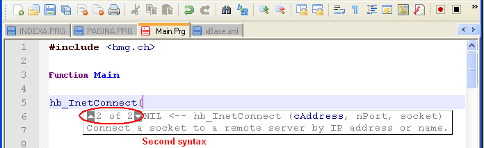

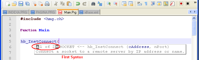

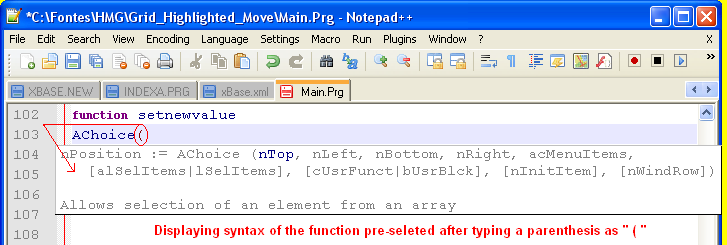

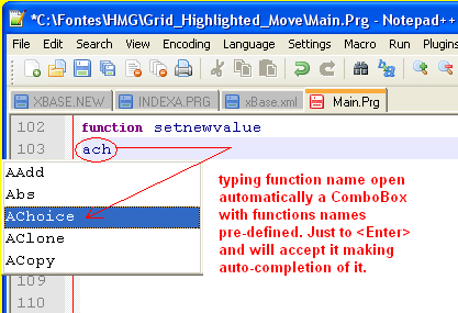

2. Style eprofissional much more elaborate, and it returns the function name in "CamelCase", only the syntax displays on the screen and follow the positioning of each parameter to measure which is added, also brief description of each function.
a. Please note that as you type the function name (in this case the first 3 characters), it will open a ComboBox with pre-existing functions, showing only the name (without parameters)
b. And when typing the parenthesis [ the character "(" ] will then show the syntax and parameters with brief description.
c. There functions over which a syntax is displayed differently. See pictures below.
To see both syntax, click the arrow button (circled in red color)
xBase functions displaying syntax.rar
(22.48 KiB) Downloaded 599 times
The auto-completion (file "xBase functions displaying syntax.rar") is only for "functions" so it was not possible to add Harbour commands. Because Notepad++ can enable the syntax thru user typing a " ( " at start and a " ) " at end which features a function with parenthesis.
