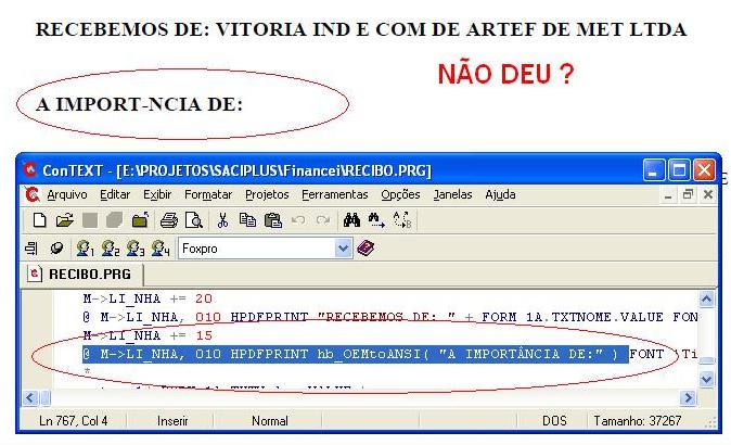

Colega nesse post você encontrará um imagem do problema, as palavras com acentuação saem se acentuacao, veja:
Colega, en este post encontrarás una imagen del problema, las palabras vienen con acentuación acentuación, ver:

Hi Hasa !
Did you try to use:
hb_OEMtoANSI( string )
If fail: Send a small sample in a reply

Colleague in this post you'll find an image of the problem, the words come up with accentuation accentuation, see:
viewtopic.php?f=40&t=2903

Did you try to use:

Are you using hmg 3.046 ( over this will not work ) ?
Context Editor using ansi or unicode for .prg files ?
*** DOS: change to ansi/win1252
Direct use of hbhpdf works fine on all my tests
