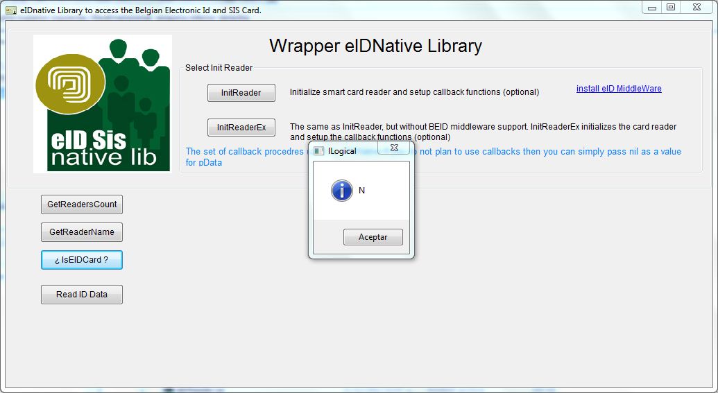

Posted: Tue Dec 11, 2012 5:28 am
Hola a Todos / Hi Everyone:
Agregando la interfaz grafica me encuentro que una parte del programa falla.
Adding the GUI I find that part of the program fails.

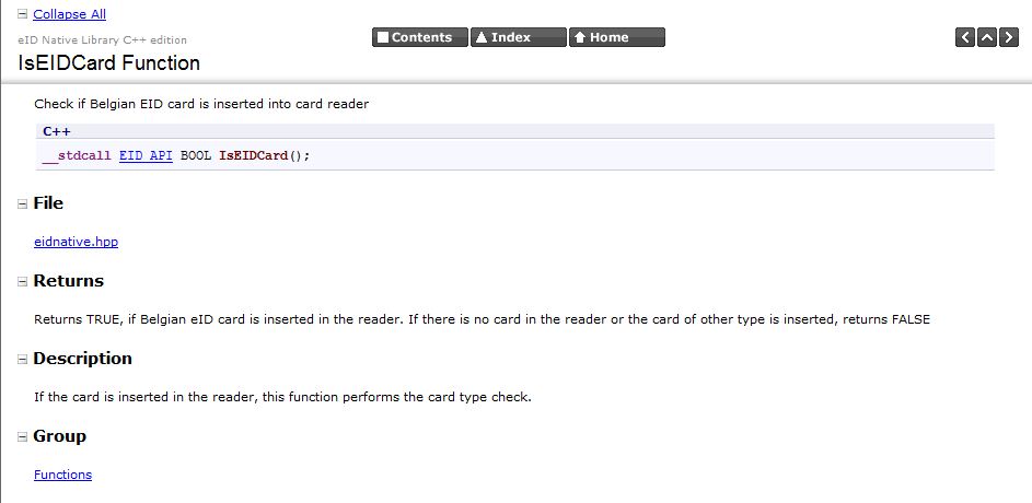

el manual de referencia dice / reference manual says :
eID Native Library C++ edition_2012-12-11_02-05-48.jpg (37.12 KiB) Viewed 7182 times
el codigo que genera ese error es este / the code that generates the error is this
Procedure ReadDataCard()
 Local lLogical := ReadIDDataCard(  oeIDIdentity )
  msginfo( VALTYPE( lLogical )  , 'lLogical')
    If lLogical
       eIDReader.cReadData.Value := 'Read identity information from Belgian eID card is OK'
       /*oeIDIdentity
       eIDReader.cName.Value := oeIDIdentity:cName
       SavePhotoAsJpegCard( 'image' )
	   eIDReader.eIDImage.Picture := 'image.jpg'
       msginfo('Read identity information from Belgian eID card' , 'False')
la funcion es esta. / function is this.
Function ReadIDDataCard( DATA )
' Name:    Function ReadIDData
' Input:
' ByRef Data As EIDIdentity - EID Identity information
' Output:
' TRUE when information is successfully received from the card;
' otherwise returns FALSE
' Purpose:
' Read identity information from Belgian eID card
' Remarks: None
Return ( CallDll32( 'ReadIDData' , cDll , DATA ) )
aqui la imagen del error. / Here the image of the error.
eIDnative Library to access the Belgian Electronic Id and SIS Card.jpg (71.39 KiB) Viewed 7182 times
tengo una variable NUMERICA antes que un variable LOGICA, no encuentro el error, algunas de las funciones retornan valores correctos y eso me hace perder y dudar que estoy haciendo mal.
esta es la aplicacion completa
eIDReader.rar
(188.39 KiB) Downloaded 380 times
gracias por la ayuda.
I have a numeric variable rather than a logical variable, can not find the error, some of the functions return correct values ​​and that makes me doubt lose and I'm doing wrong.
This is the complete application
[attachment = 0] eIDReader.rar [/ attachment]
thanks for the help.
