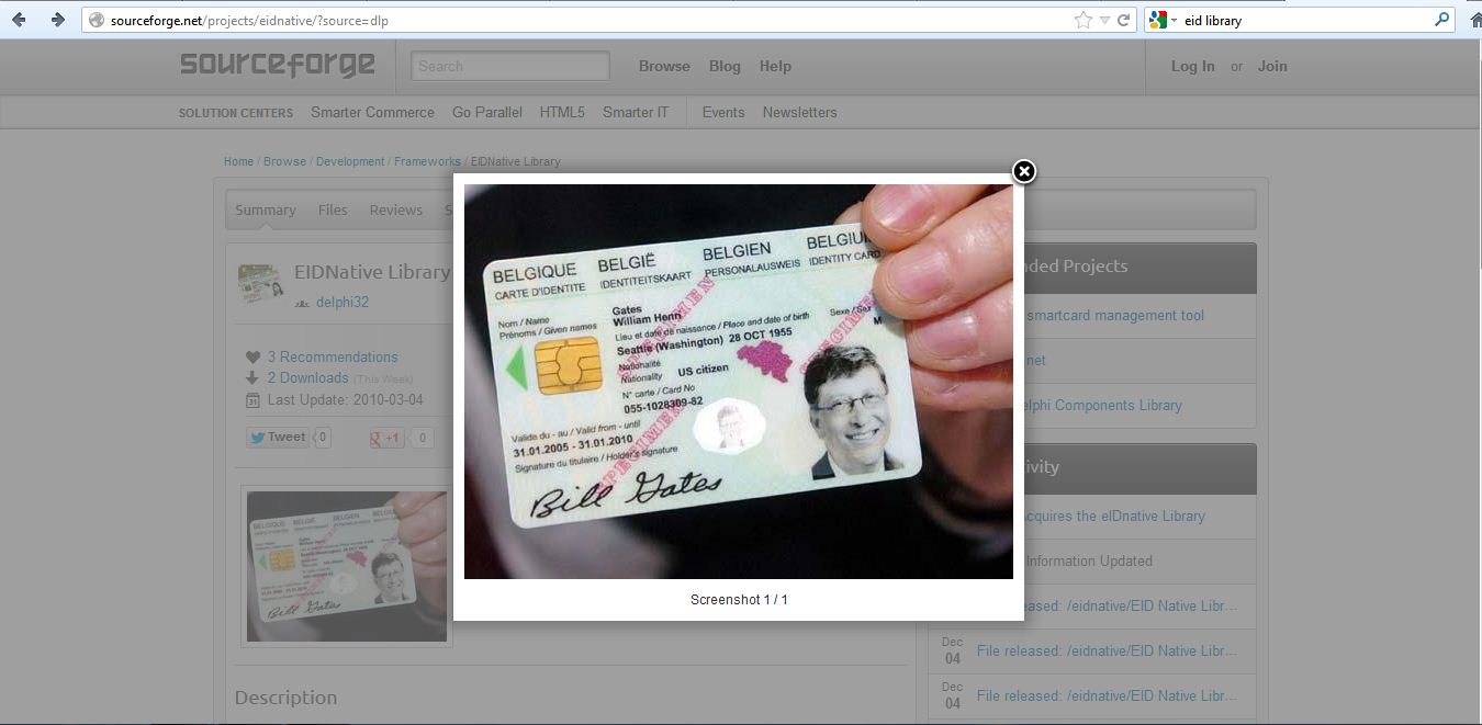

Hola Serge :
aqui le encontre la solución, tiene todo lo necesario para trabajar con EID Library.
Hi Serge:
I found the solution here, has everything you need to work with EID Library.
http://sourceforge.net/projects/eidnative/?source=dlp

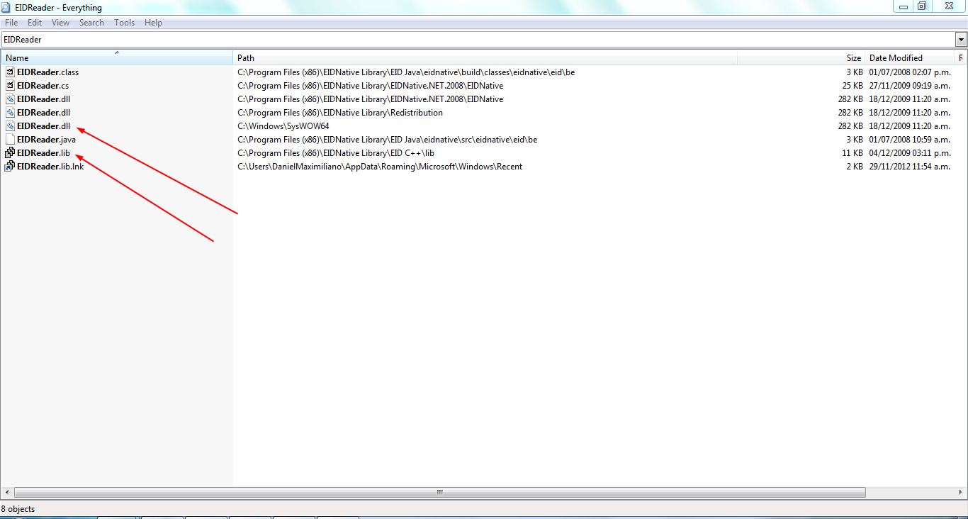

The EIdReader.DLL is in the windows directory.
What about EIDReader.LIB ??
