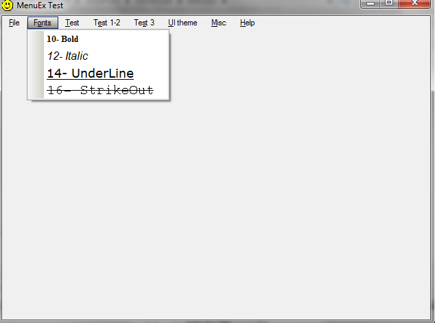

Maybe you can do this with "extended menu" of "MiniGUI extended". See the example at: <C:\MiniGUI\SAMPLES\Advanced\MenuEx\demo.prg>
See this image:
Rossine.
Change Size Menuitem im hmg.4
Posted: Fri Dec 23, 2011 4:55 pm
Thank again Rossine. I also note this in HMGE, but I would like to do all in HMG3. Seems that in HMG3 is missing this parameter. Any way I should change developement tool.
