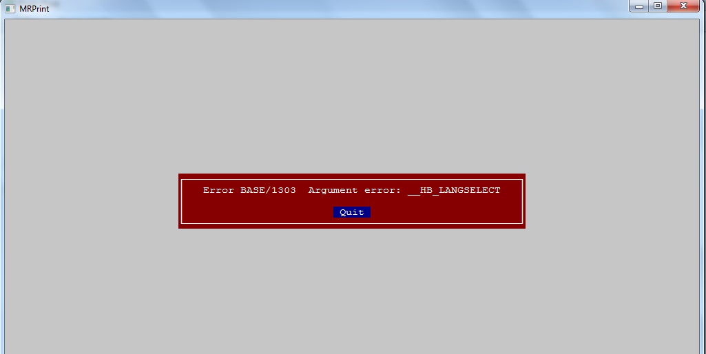

by Javier Tovar
Wanting to run the MRPrint.exe gives me the following error:
Error MRPrint.jpg (33.01 KiB) Viewed 3573 times

Re: Como imprimir textos con orientacion diferente
Posted: Mon Sep 08, 2014 3:31 am
Javier Tovar wrote:...
Any idea?
Yes :
If you are a programmer
    you will solve easily  these problems;
    this project don't have any meaning to you.
Posted: Mon Sep 08, 2014 4:01 pm
by IMATECH
Hi just change contents to:
File: demo.prg
PROCEDURE F_Set_Desktop()
   hb_langSelect( "PT" )
   hb_cdpSelect( "UTF8EX" )
Then study "demo.hbp"... and build the sample
