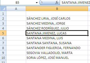

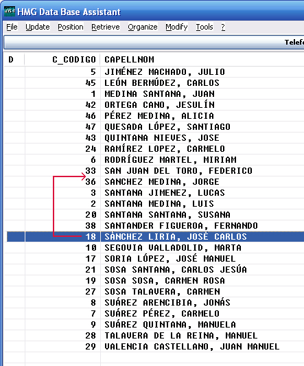

Thanks Esgici, that's a good work.
That's work well, but I think I've made a mistake because in spanish A and Á are the same words, also a and á, and so long {E = É; e =é; I = Í; i = í; O = Ó; o = ó; U = Ú and u = ú}. For example:
This is how Excel makes the sequence:
Orden Excel
Orden Excel
And this is my index sequence:
Orden Index
Orden Index
Thanks.

Algernon wrote:Thanks Esgici, that's a good work.
Hola Algernon
I'm glad that you like it :)
In this implementation there isn't "equal" letter, each letter is small (before) or great (after) than another one.
Regarding your example, for sequencing Excel like, please simply change your string from
#define cEspCharSet "AÁaáBbCcDdEÉeé...
to
#define cEspCharSet "ÁAáaBbCcDdÉEée...
I hope that this will produce expected result.
