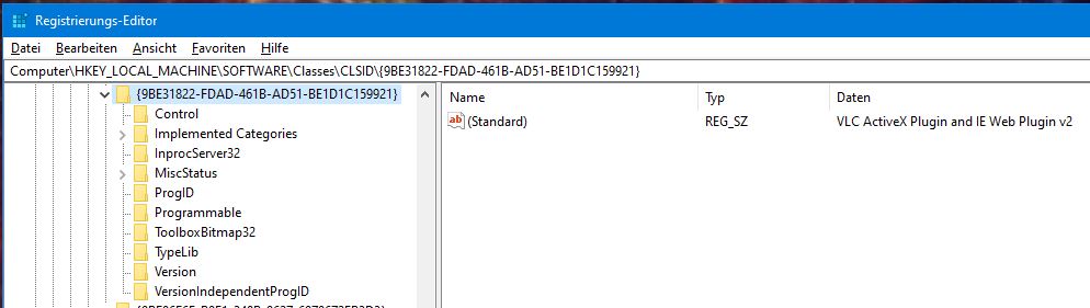

Re: VLC for HMG
Posted: Tue May 04, 2021 8:22 am
by chrisjx2002
I try again.
With 32 bit version it works!
With 64 bits always problem. I try with "{9BE31822-FDAD-461B-AD51-BE1D1C159921}"instead of "VideoLAN.VLCPlugin.2". Same problem.
When I change the code, I have not the message "VLC not correct installed" but the same error. See screnshot.
I search the progid in regedit. See screenshot.
Re: VLC for HMG
Posted: Tue May 04, 2021 9:54 am
by AUGE_OHR
chrisjx2002 wrote: Tue May 04, 2021 8:22 am With 32 bit version it works!
mystery ... 32 Bit is working and 64 Registry "seem" OK but does not work ... :o

Posted: Wed May 05, 2021 12:18 pm
by chrisjx2002
I have perhaps found the problem. I compile with hmg 32 bits and not 64 bits. It is probably why it does not work.
Re: VLC for HMG
Posted: Wed May 05, 2021 5:14 pm
by chrisjx2002
Got it! It was a problem of 64 bits compilation. Now it works!
