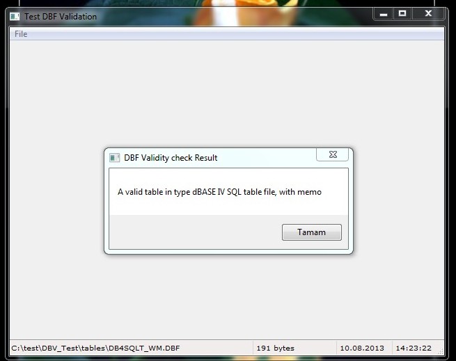

This little work try testing a .dbf file for validation.
No perfect nor claim to find all problems; simply try help as far as possible.
As always, all bug reports, critics and suggestions in any kind are welcome :arrow:
Scren shoot of DB_Valid test

Esgici wrote:Damaged data files are nightmare of programmers
Yes, it is !
Would it be good to find a function that could reconstruct the structure of dbf and could take all data and replace in a corrected structure. As FixFile of old Norton Guide. :)
Esgici wrote:This little work try testing a .dbf file for validation.
In Stru.prg there is a function that recognize the type of dbf and check if memo file is missing, then it is created according the dbf type. But is creating a empty memo just to be able to open the dbf.
Hi Pablo
Thank to your interest :)
As name implied, mission of this function is only check and report validity of a .dbf file; not fix probable hazards.
As you noticed, there are clever programs, works to repair tables.
