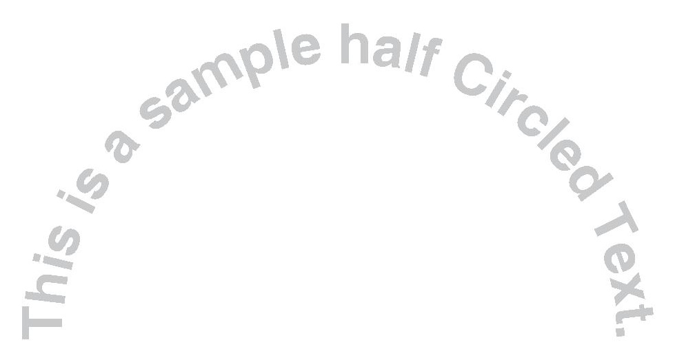

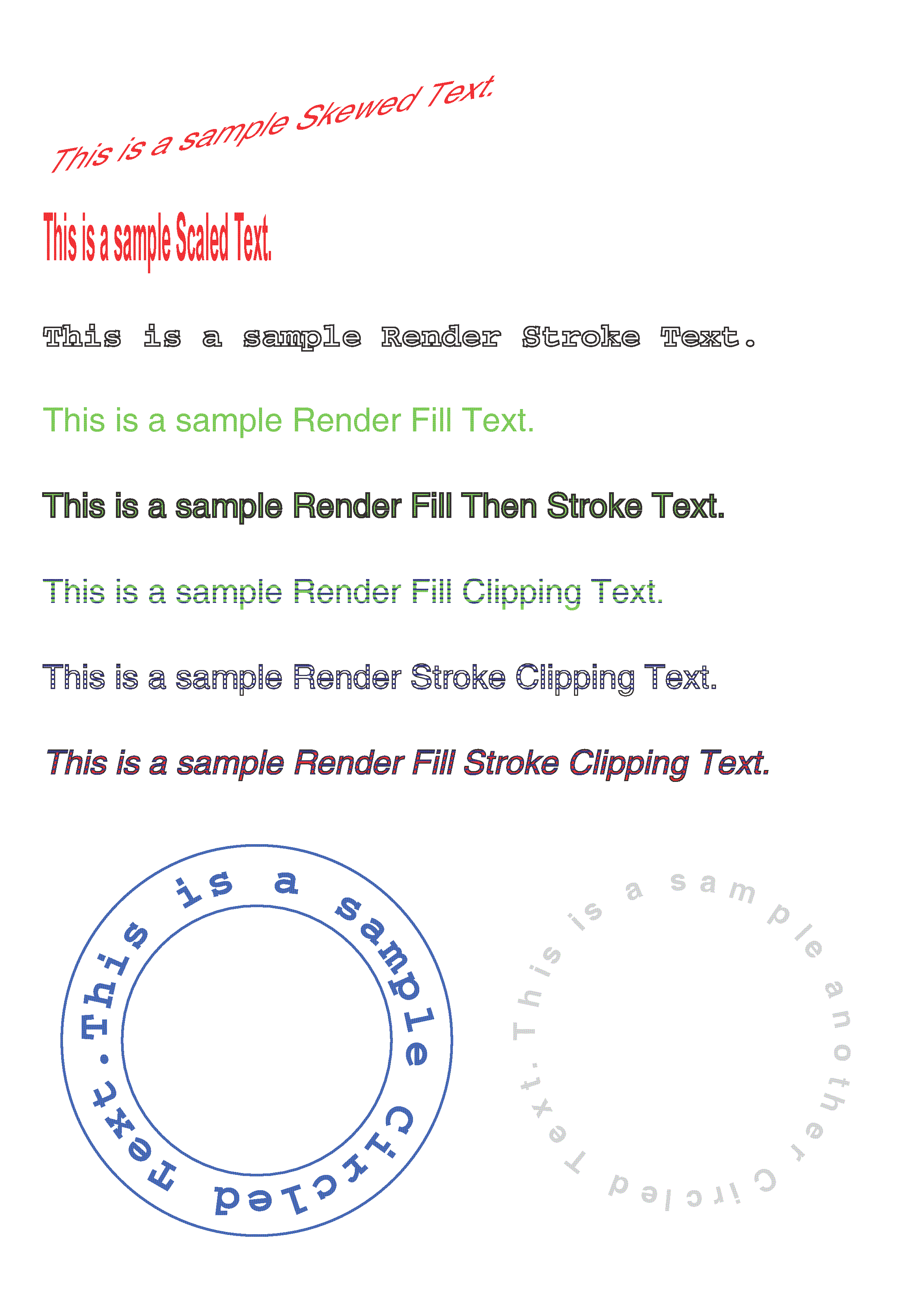

EduardoLuis wrote: Tue Mar 06, 2018 1:19 pm Hi EDK:
After looking all HARU i try unsuccesfully to replicate the types that appear on attached pdf page.
Searching for that controls they exist on HPDF library.
As promised, I present new features:

***************  The end of this part of the code. *********************
Function Main()
SELECT HPDFDOC "sample.pdf" PAPERLENGTH 300 PAPERWIDTH 300 LOG
START HPDFDOC
	SET HPDFDOC ENCODING TO "WinAnsiEncoding"
	START HPDFPAGE
		@ 20 , 10 HPDFPRINT SKEW "This is a sample Skewed Text." SIZE 22 COLOR {255,0,0} ANGLE 10 SKEW 33
		@ 40 , 10 HPDFPRINT SCALE "This is a sample Scaled Text." FONT "Arial" SIZE 22 BOLD COLOR {255,0,0} XSCALE 0.5 YSCALE 2
		@ 60 , 10 HPDFPRINT RENDER "This is a sample Render Stroke Text." FONT "Courier" SIZE 22 BOLD COLOR {0,255,0} STROKE RIM 0.8
		@ 80 , 10 HPDFPRINT RENDER "This is a sample Render Fill Text." SIZE 22 COLOR {0,255,0} FILL RIM 0.5
		@ 100 , 10 HPDFPRINT RENDER "This is a sample Render Fill Then Stroke Text." SIZE 22 COLOR {0,255,0} FILL_THEN_STROKE RIM 1
		@ 120 , 10 HPDFPRINT RENDER "This is a sample Render Fill Clipping Text." SIZE 22 COLOR {0,255,0} FILL_CLIPPING RIM 0.5
		@ 140 , 10 HPDFPRINT RENDER "This is a sample Render Stroke Clipping Text." SIZE 22 COLOR {0,255,0} STROKE_CLIPPING RIM 0.5
		@ 160 , 10 HPDFPRINT RENDER "This is a sample Render Fill Stroke Clipping Text." SIZE 22 ITALIC COLOR {255,0,0} FILL_STROKE_CLIPPING RIM 0.5
		@ 230 , 60 HPDFPRINT CIRCLED TEXT "This is a sample Circled Text." FONT "Courier" SIZE 30 BOLD COLOR {0,0,255} RADIUS 35 RIMS
		@ 230 , 160 HPDFPRINT CIRCLED TEXT "This is a sample another Circled Text. " SIZE 20 BOLD COLOR {200,200,200} RADIUS 35
	END HPDFPAGE
END HPDFDOC
Execute File 'sample.pdf'

I upload as a stand alone prg, but if you want, you can successfully attach new functions to h_HMG_HPDF.Prg and the commands to hmg_hpdf.ch.
Edward.

Hi Edward:
Excellent, you got it.-
I've download your .prg and soon testing.-
Thanks for your effort and thanks to share your knowledge with us.
With regards.
Eduardo

If you want to get such an effect, for example:
just change the circle circumference length from 360 to 180 at line 505: ;)
nPxAng: = 180 / HPDF_Page_TextWidth (hPage, cText)
1/4 = 90
3/4 = 270
It's pure geometry ;).
Edward.
